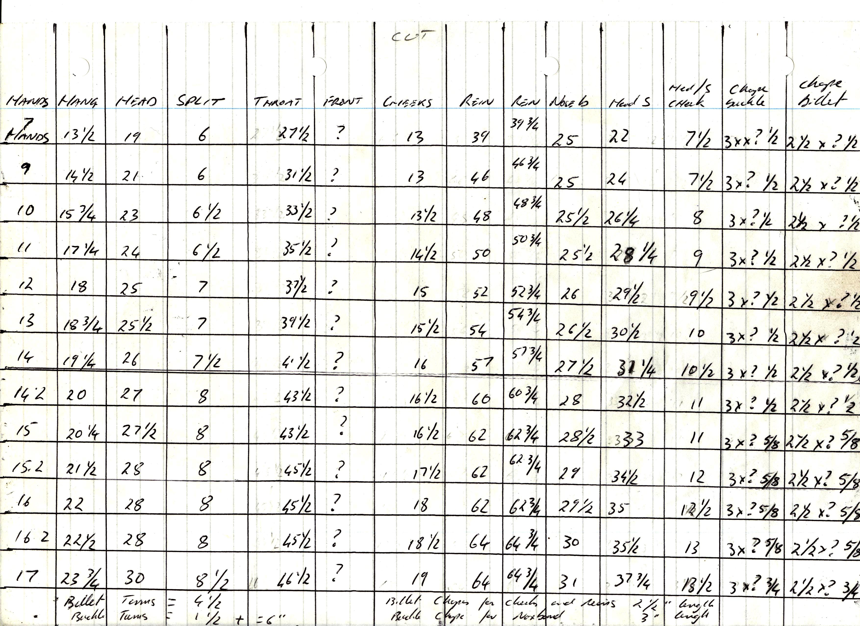

Now you are wondering, he has slipped in something called Cut Size here? Have faith. Here is the Cut Size chart!
You will note that the FRONT ( Brow band) column is empty. This because until you have decided the width of your headpiece, you cannot decide the cit size for the Front. So Use the Made Up size and add the 2 loops (over the Headpiece) 2 x 1/2" for the bend and 2 x 1" for the stiching.

CUT SIZE CHART.
post-31019-014048200 1336322356_thumb.jp
These cut sizes make allowances for l the turns and stiching at buckle ends, the turns and billet ends of reins and cheeks etc etc
