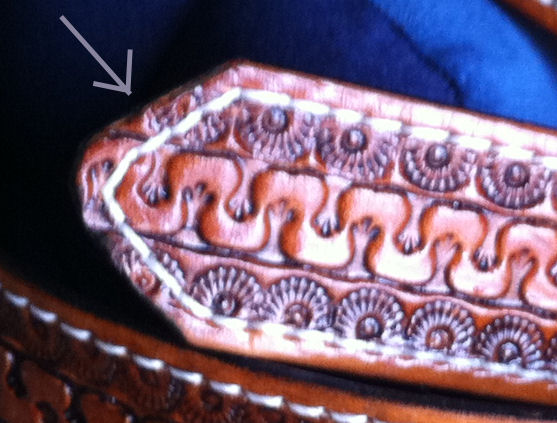

mlapaglia Posted September 3, 2012 Report Posted September 3, 2012 (edited) Tool first before you glue together. Neetsfoot oil after its been cased and tooled. Herman Oak is good leather. The only time to oil first is when the leather is really dried out. You oil after to replenish the oils removed by casing and tooling. I stitch 1/8th to 1/4 from the edge depending on my tooling border. I tend to antique the tooling to make it stand out so I do 2 coats of 50/50 resolene then antique, then 1 coat 50/50 resolene then finish with Fiebings Leather Balm w/atom wax or a mixture of carnuba wax, bees wax and neetsfoot oil. Rub in with my fingers and a hair dryer to make it soak the waxs in. Then buff. To be honest I use the leather balm and atom wax more than the homemade carnuba/bees wax. It's just easier. Its like most times I machine sew the belt but if I really want to do it the best, I saddle stitch it. The home made finish is just more hand made effort. Reserved for those people I want to do something real special for. This belt was tooled with a 1/4" border and the stitch line against the tooled border. its a 1.5" belt. dont make the mistake I did. Make sure you leave the border at the tip of the billet so it does not look like you took a length of tooled strap and cut it off to make a belt. It looks better to have the border around the tip. This is wrong This is the better way to do it.. That belt finally finished with a stitch line at 1/8" Edited September 3, 2012 by mlapaglia Quote The key to immortality is first living a life worth remembering. Bruce Lee

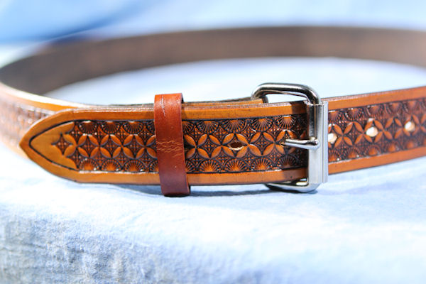

Members katsass Posted September 3, 2012 Members Report Posted September 3, 2012 (edited) From the grump: Here's how I do mine. This happens to be a 2" wide, tapered belt of 12/13oz saddle skirting, hand stitched and lined with 2/3oz veg tanned cow hide..Just a very plain gunbelt. Mike Edited September 3, 2012 by katsass Quote NOTE TO SELF: Never try to hold a cat and an operating Dust buster at the same time!! At my age I find that I can live without sex..........but not without my glasses. Being old has an advantage.......nobody expects me to do anything in a hurry.

mlapaglia Posted September 4, 2012 Report Posted September 4, 2012 I agree with the border around the tip of the billet. That's the way I do mine. I agree that it looks like you used something stamped out with a roller when you don't take it around the tip. I really like the meander pattern. I've never done a meander pattern and don't even have a tool for it. I see one in my near future. It just has a cool look. Also like the stitch line at 1/8". I've also seen a double stitch line that looks good but that leaves less space for tooling. I have 3 or 4 different types of meandering tools each in at least 2 sizes. I really like the pattern you can get with it. Once you get the spacing down its easy to do. Thanks Michael Quote The key to immortality is first living a life worth remembering. Bruce Lee
Members katsass Posted September 4, 2012 Members Report Posted September 4, 2012 Hey Grump! I like the wide belt. Couple of questions. How does it fit through regular jeans belt loops? I guess most holster belt loops would be too small also. Then again, that's what it's all about....a custom belt requires a custom holster! I'm assuming that this belt was intended to go through belt loops on pants. Or is it to wear over the top of your pants/belt and have a holster slide over it like a police duty rig? You know, the roller buckle isn't as fancy as some other buckles, but it sure has to be a lot easier to use on thicker, wider belts. I've got some smaller roller buckles, but I'm going to get some wider ones to try on my gun belts. Can't wait to make a new double thick belt with nice stitching from my NEW Cobra machine! Well, as to the 2" wide belt, I don't think it will fit through standard Levi's belt loops. The customer wrote me and ordered a 40", 2" wide gunbelt, with no loops, so I expect it was to be worn over his standard belt with the holster slipped over it. For heavy belts (total of 15oz or so) the roller buckle seems to work better than a standard heel-bar or center-bar buckle. You'll be doing the stitching a lot quicker on your machine - but, there is nothing quite like a heavy, hand stitched rig IMHO. Mike Quote NOTE TO SELF: Never try to hold a cat and an operating Dust buster at the same time!! At my age I find that I can live without sex..........but not without my glasses. Being old has an advantage.......nobody expects me to do anything in a hurry.
