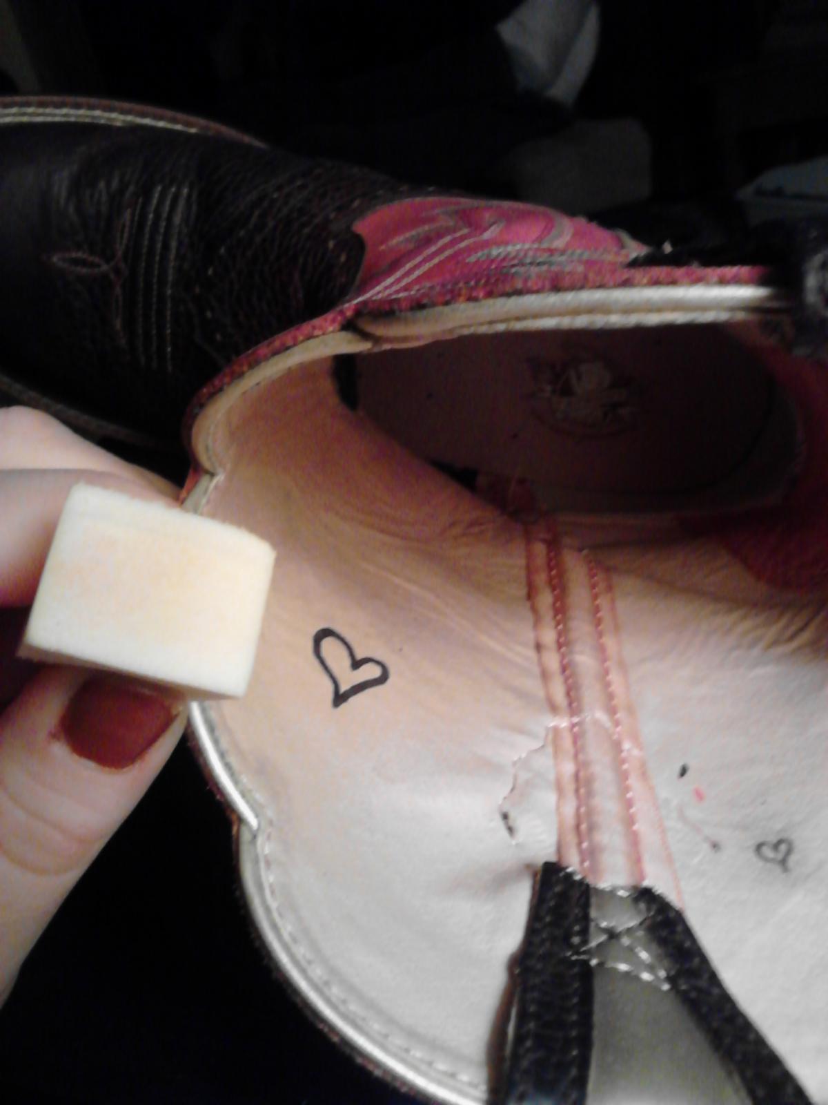

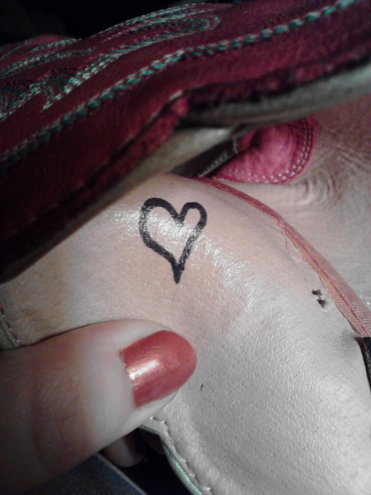

Members Cyberthrasher Posted February 7, 2013 Members Report Posted February 7, 2013 If you do try it out with the spray bottle, let me know! If I apply it 50/50 and just do a thin coat, how many coats do you put on? I don't want it too thick or it will crack, right? I'll definitely report back. It will just depend on if I have a spare bottle somewhere. With the thinned Resolene, I usually apply 2 LIGHT coats about 15 minutes or so apart. You can get 3 on there, but if it's not needed than I wouldn't worry about it. Just remember to thin it and make sure it's not bubbly or streaky when it's applied (which shouldn't happen if it's sprayed). If you blot with a sponge, again, do it lightly and eliminate any bubbles. Don't over saturate the sponge with it or you will get bubbles. Resolene is pretty flexible ( I use it on all my belts and guitar straps), so it will hold up well as long as it's not too heavy. Quote hellhoundkustoms.wordpress.com www.facebook.com/hellhoundkustoms www.etsy.com/shop/HellhoundKustoms

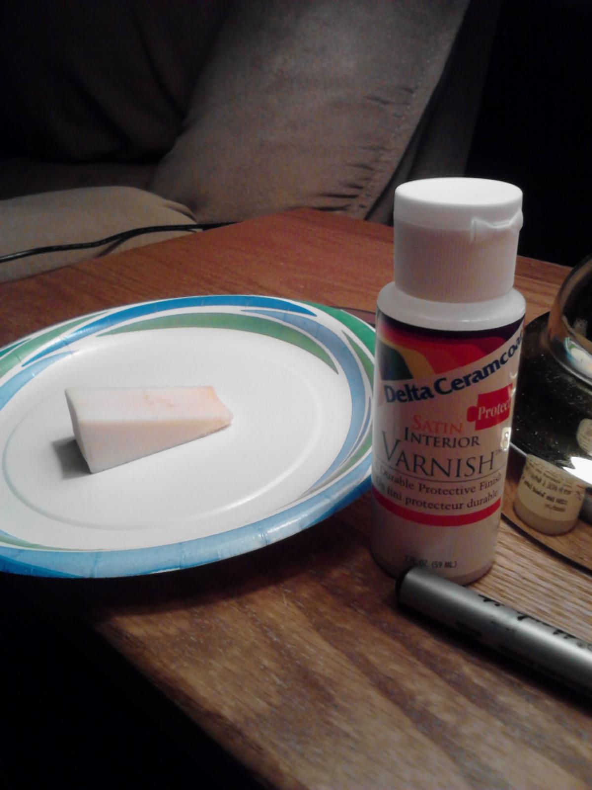

Members elf3 Posted February 10, 2013 Author Members Report Posted February 10, 2013 One and the same (floor wax), just make sure it is plain, no perfumes or such in it. Soldiers have been using it on their boots for years, and many leather workers use it to seal their projects because it is much more cost effective. So I have the boot masked and went to spray and I thought I would read this thread again. I looked at the bottle I bought and way down in the corner it says "fresh citrus scent" I'm assuming I shouldn't use it walmart didn't carry mop n glo here and the store I found this at only had the one bottle. It is blue. Guess I should just pay the extra to get the resolene. Quote
