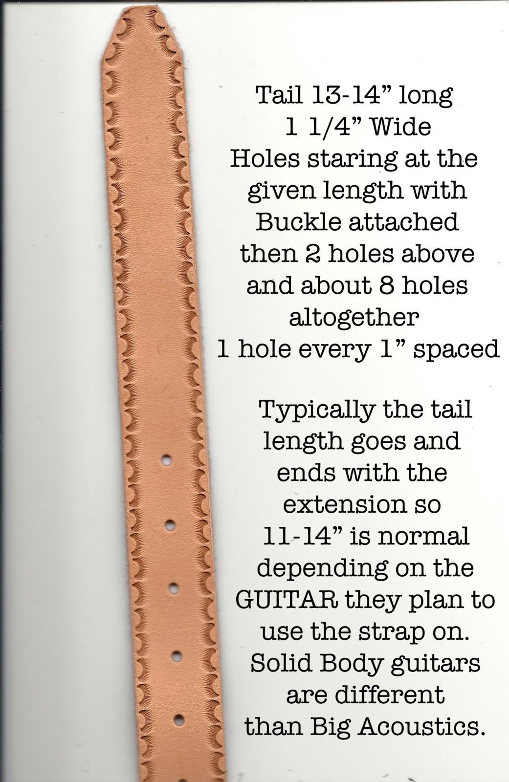

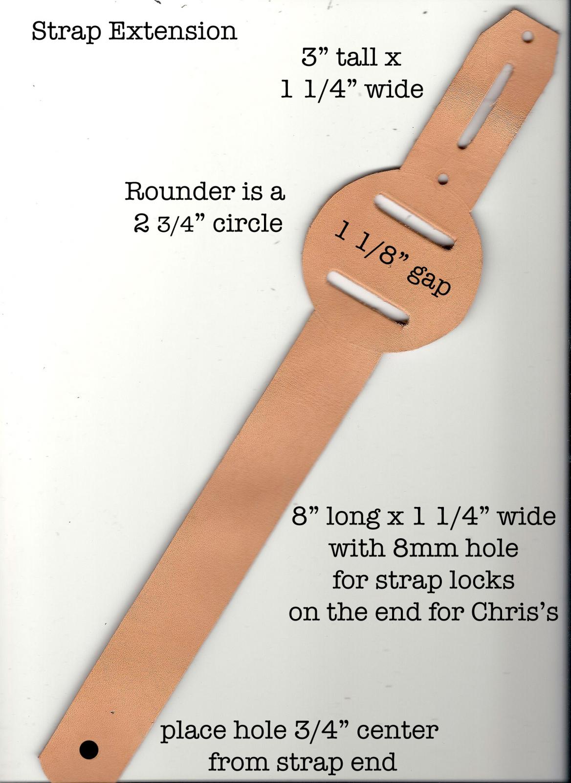

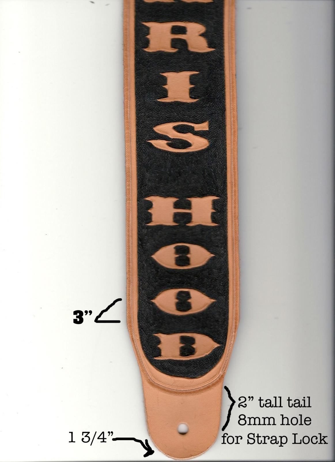

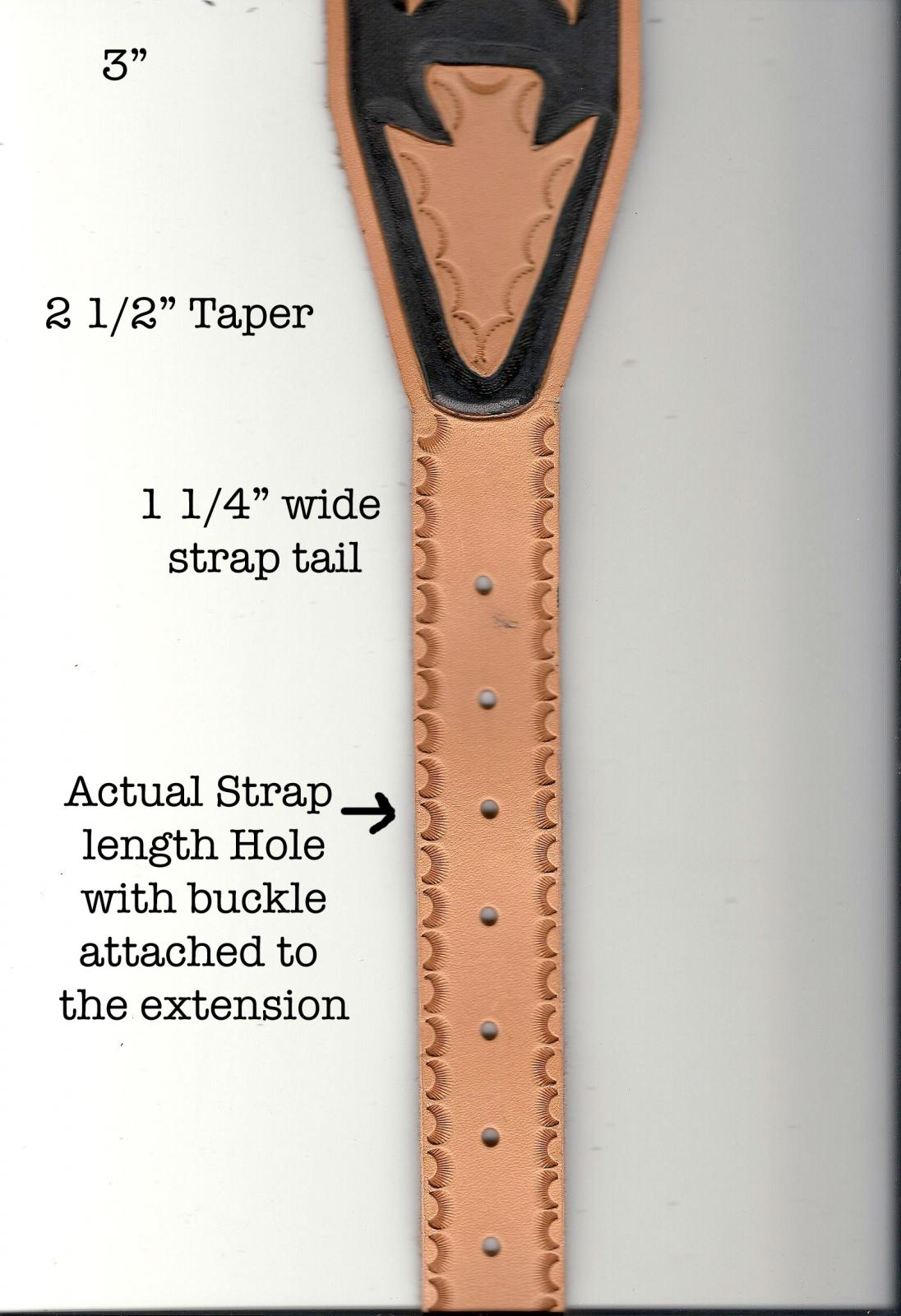

just use those:9 or the buckle strap just make a strap and add a buckle:) A gift from me to the community:)
If it's good enough for Merle its good enough for us! I just personally prefer my ends a little wider than his.
post-28433-0-66181200-1370028800_thumb.j
post-28433-0-30931400-1370028808_thumb.j
post-28433-0-94271900-1370028823_thumb.j
post-28433-0-64722200-1370028881_thumb.j
post-28433-0-37526900-1370029088_thumb.j
Edited by chancey77
thank you sir.........very helpful.
No problem! I just started a new topic for this! Check there and leave comments and pics after you have made your version! There is more instructions there.
