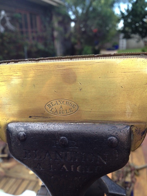

[G'day Tor,
I will post these photo's of my plough gauges, 30 in number.
Some are branded:- Blanchard, George Barnesly, Fox, Various models of Dixon, Brindley, Mayer & Flamery, etc.
The last two photo's are of a clamp for stitching gloves or as Walter has suggested it could also be used for saddlery.
Regards
Alan

Hello Alan!
Wow, I'm with out words! That's a great collection of plough gauges! I wonder where they all had gone, now I know :) I recognize most of the makes. There is at least one or two I have never seen before. The last pic before the gloves clam, what does it read? " PARISOTF.LS PARIS" Thats what it looks like to me? The "Portrait Paris" I have seen once before. Nevertheless, it's unusual too.
(Mayer Flamery (Fernand Mayer) was copies of the Blanchard tools. He was an old master employed in Simonin Blanchards workshop. He left and took their tool catalog with him. He started his own production copying their tools. Blanchard used the law against him and shut him down. He was allowed to continued produce his splitting machine, who was unique and very popular.)
In your picture # 3, I see a plough who is very unusual too. It looks very much like S. Blanchards # 602 in their old catalog. It's an early version of today's Vergez Blanchard model perhaps. I cannot see the maker on in (left in your pic #3)
In your pic #5 (image4.jpg) it's an German plough from what Walter describes as the "Horse man" or perhaps "Langenhans". I belive Walter has that same tool, it's missing it's top adj.screw.
That glove clam is beautiful, I've seen a drawing of it in the tool dictionary (Dic. of Leather working tools, R.A. Salaman). Perhaps seen one for sale on Ebay a long time ago. You can use it for other leather work too jaws are made of brass and will not stain. You can use some leather around the jaws to eliminate markings.
I see you have have several German Pfaffrath plough too (Three of them, bottom your pic # 1) I got one new one too. Mine is made in such way that the knife is pointing to the left, pushing the leather away from the guide. It makes it impossible cut trailer straps with it. I think that is a production error. It also have a little removable peg (guide) on the right side of the knife for cutting in circles. I wonder are yours made like that too. You see the piece that the knife is bolted on to is 2,5 mm thicker in the front that the back; making the knife pointing against the material guide. If it was constructed exactly opposite, it would have preformed well and pressed the material against the guide (not from it like now). I have to put some shims between the blade and the frame to correct this error. Looks like it been made in a hurry.
My latest plough is a a J. Dixon screw plough who is a bit different from yours, I wonder how many different models he made.
I sorry for the long post, it's such an interesting subject these tools.
