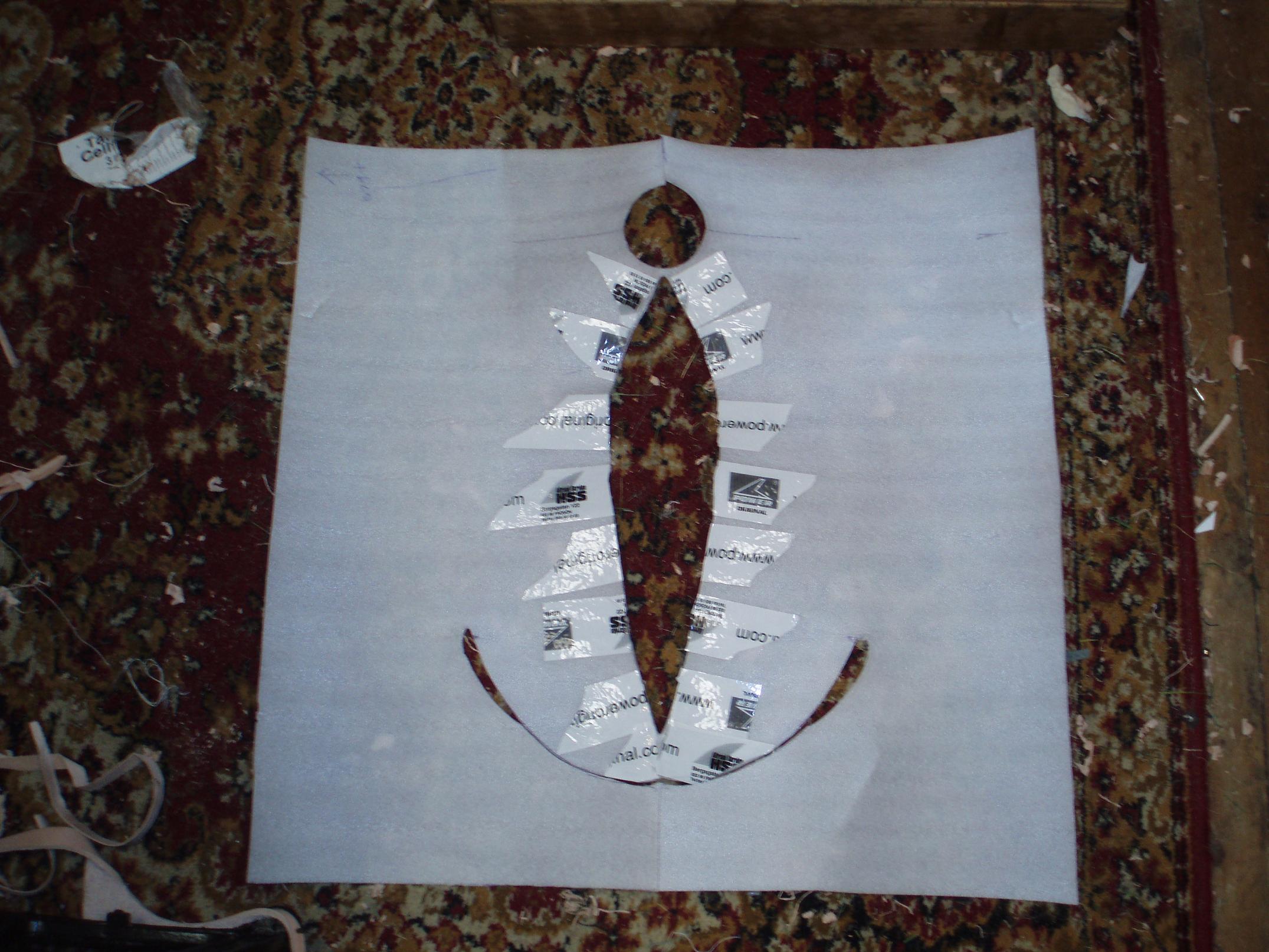

Members oldtimer Posted September 2, 2009 Author Members Report Posted September 2, 2009 Today I started making templates for the mochila. I finally found a suitable material in a building material store, a roll of 1/8" plastic foam . To avoid wrinkles under the thigh area a lot of material must be removed from the center of the seat, and for that reason there is no way to avoid a center lacing of the seat. Packing tape and plastic foam made my day! Now I´ll make some adjustments and make a final cardboard template before cutting leather. The sun is shining today! / Knut Quote

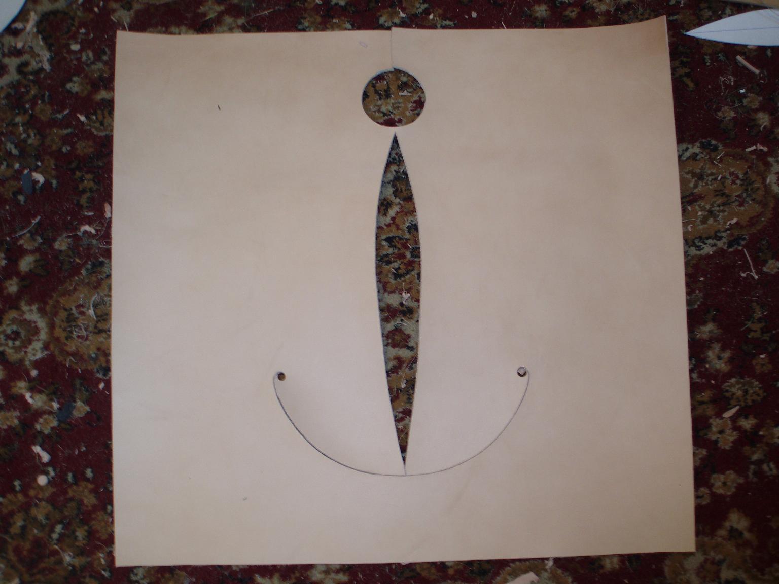

Members oldtimer Posted September 9, 2009 Author Members Report Posted September 9, 2009 (edited) After a long thought this morning, (two cups of coffee during complete silence) I put the poster board pattern on the leather, honed a knife and made the cuts. I then made a lace string, cut the holes and laced the seat part together. I chose a plain, simple lacing as I think that was the way a saddlemaker of 1830 made it, no fancy stuff, just plain, simple and functional. Next step, tomorrow, I ´ll case the leather and shape it , adjust the front line and attach a buckle and billet in front of the horn. / Knut So far, so good ! No big loss of leather ! Edited September 9, 2009 by oldtimer Quote

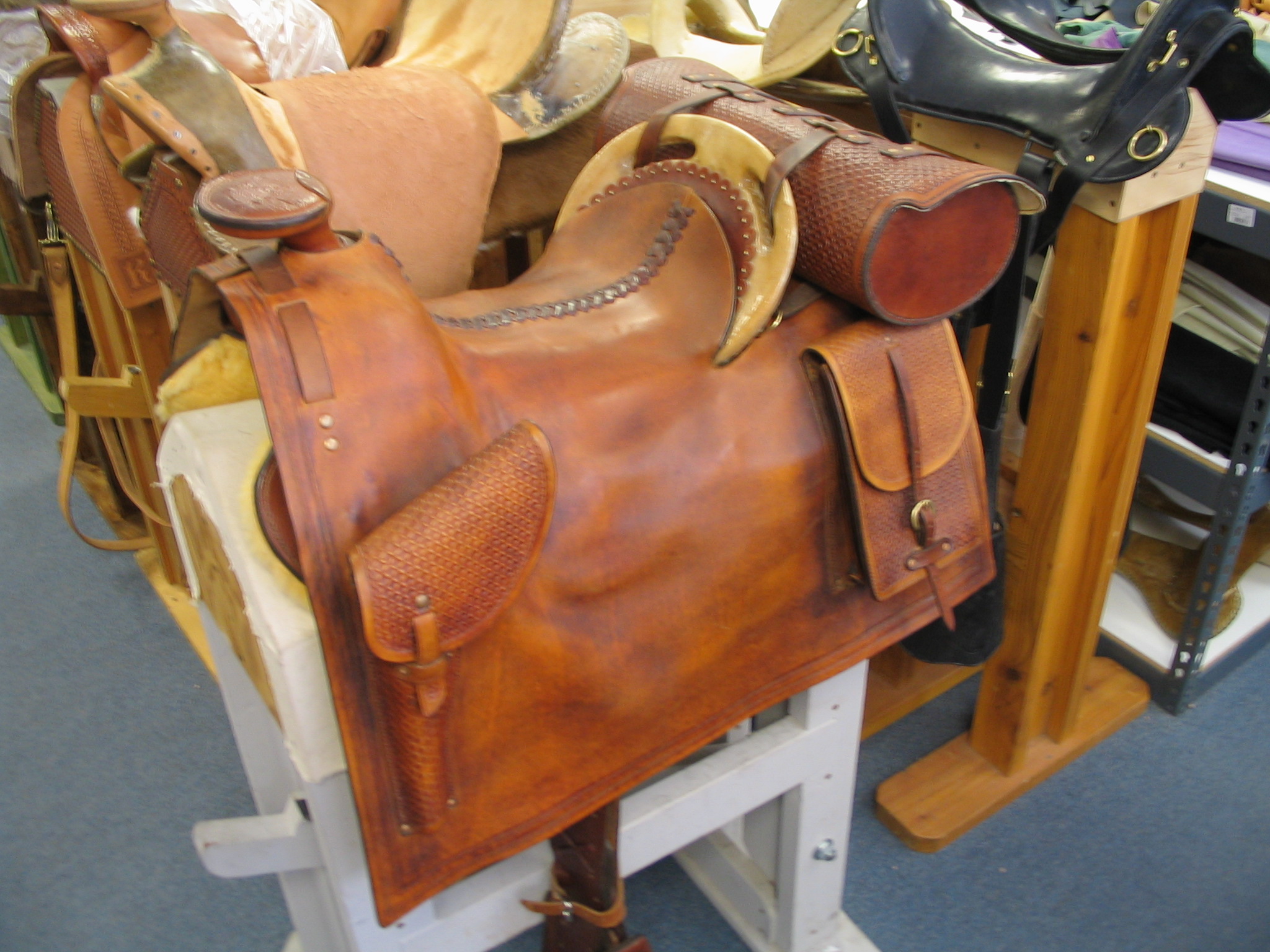

Members Traveller Posted September 12, 2009 Members Report Posted September 12, 2009 Very nice! I've attached a couple of photos of another mochilla that Yonatan, a contributor to this forum, sent me a few months ago. Quote
Members Traveller Posted September 12, 2009 Members Report Posted September 12, 2009 Very nice! I've attached a couple of photos of another mochilla that Yonatan, a contributor to this forum, sent me a few months ago. I just want to say that Yonatan sent me the photos and not the saddle! I don't know much about it except that it looks very interesting. Quote
