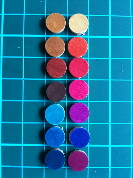

Members cem Posted December 18, 2014 Members Report Posted December 18, 2014 (edited) The only other ones I know of is Craftsha dye from Japan and Roapas Batik also from Japan both are water based but the Batik has an off putting smell to me kind of like vinegar so I prefer the Craftsha both are better quality than the Eco-Flo stuff though. I haven't used the dark brown in the Roapas Batik only grey and beige so can't tell you exactly what it is like. The Roapas Batik is available from both http://www.leathercrafttools.com and http://www.goodsjapan.com (they are down for stocktake at the moment though). There are some other places that stock it as well but I haven't used them. Goods japan used to stock the Craftsha but it's been awhile since I've bought any and they didn't have any listed a couple of weeks ago I expect both stores should be able to order it in though. The Craftsha also comes in larger bottles of 500ml for some colours http://translate.google.com.au/translate?hl=en&sl=ja&u=http://www.craftsha.co.jp/&prev=search I've attached a photo of most of the Craftsha colours the dark brown fourth on left side is number 10 on Craftsha's colour chart. Hope this helps a bit Edited December 18, 2014 by cem Quote
Members zaynexpetty Posted December 18, 2014 Author Members Report Posted December 18, 2014 The only other ones I know of is Craftsha dye from Japan and Roapas Batik also from Japan both are water based but the Batik has an off putting smell to me kind of like vinegar so I prefer the Craftsha both are better quality than the Eco-Flo stuff though. I haven't used the dark brown in the Roapas Batik only grey and beige so can't tell you exactly what it is like. The Roapas Batik is available from both http://www.leathercrafttools.com and http://www.goodsjapan.com (they are down for stocktake at the moment though). There are some other places that stock it as well but I haven't used them. Goods japan used to stock the Craftsha but it's been awhile since I've bought any and they didn't have any listed a couple of weeks ago I expect both stores should be able to order it in though. The Craftsha also comes in larger bottles of 500ml for some colours http://translate.google.com.au/translate?hl=en&sl=ja&u=http://www.craftsha.co.jp/&prev=search I've attached a photo of most of the Craftsha colours the dark brown fourth on left side is number 10 on Craftsha's colour chart. Craftsha-Dye.jpg Hope this helps a bit That helps a lot, thanks for the advice! I contacted leathercrafttools.com and they responded saying that they can probably get them for me. Do you know how much they charged in your currency for the two different sizes? Quote
