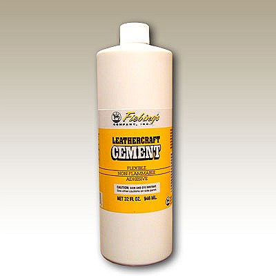

Chief31794 Posted December 21, 2014 Report Posted December 21, 2014 Actually, leathercraft cement (the white stuff), is very strong and is a contact type cement. It actually works either way but the best way is to coat both pieces, let them dry till tacky and then put them together, it will not come back apart, has no odor, is water based and if you need longer "working time" to align pieces you can put them together while they're wet and align them, still very strong when dry. I normally like to put an old carving slab on the piece either way and let dry for about 30 mintues, not necessary when doing it contact style, but still doesn't hurt and I use the time to do other things on the project. I use Feibings Contact Cement from Springfield Leather. Chief Quote
