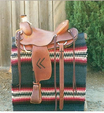

I am attaching a couple pics of some of my saddles to illustrate a centered seat vs. a posterior seat. The slickfork with the corner stamping is pretty typical for my "centerish" seat. The branded fender saddle was done with the posterior seat by request. This guy wanted that seat because that he is what he wanted. It is a definite ramped up narrow posterior seat. He wanted to be able to grip something standing up from front to back - he can.
