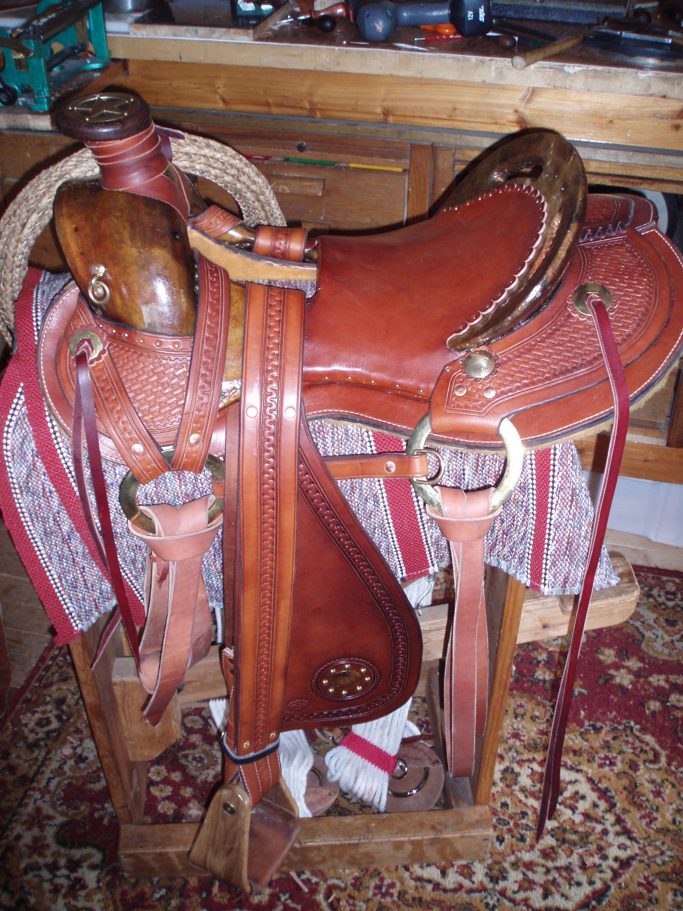

Hey Buffalo. I have built a couple of half seat saddles, the latest project was a Santa Fe style saddle for my own use ( to keep weight down on the trail). A half seat saddle , with the groundseat properly installed and shaped, makes a very comfortable piece to ride. I built the front rigging old mexican style and installed a rosewood horn cap with a brass Texas Star (to cover the screw heads). There are no special tricks to build a half seat. I have used my saddle for a couple of years, riding week long trails up in the Swedish mountains, and I won´t trade it for a regular western saddle.
My next saddle project will be a half seat saddle built on a Wade tree.
"If you ain´t riding a half seat, you might just as well walk" :spoton:

A "Tejas style" Santa Fe saddle, Mexican double rigging, Rosewood horn cap with an inletted solid brass Texas star, built on a Santa Fe Full QH tree from Timberline. Weight: 11 kilos. A comfortable and practical piece of equipment for the trail
Oldtimer, I love this saddle!! Its nearly the exact saddle I want to have built for my Spanish Mustangs. With a Meana or Santa Fe slick fork tree made from a mold of my SM's back of course and including a Sam Stagg rigging. lol Very nice saddle!!!!
