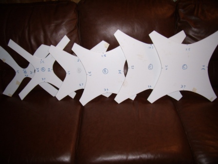

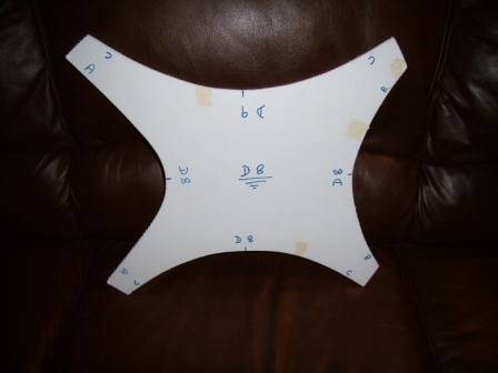

1.) Become familiar with the cards. There are four different shapes (S4, S5, S6, S7) on the S cards and four (D4, D5, D6, D7) on the D cards for each of the A, B and C positions.
There is one extra card that has the A, B, and C position for shape D8, and a D9 shape for the C position.

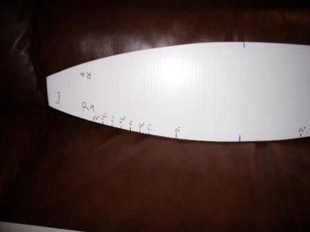

There are three shapes to determine rock – R9 is the middle, R6 is flatter and R12 has the most curve.
There is a "ruler" on a rock card to help you measure more conveniently.

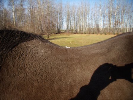

2.) Stand your horse as squarely as possible on flat ground. Find the lowest spot on your horse's back. This is the B position. Note: this spot corresponds to the 14th vertebrae and is situated above the horse's center of gravity when standing still. This is a consistent point on all horses from which all the other measurements are taken, making the system a consistent way to compare horses.
3.) Using a ruler, mark a spot 8" behind this spot. This is the C position.
4.) Feel for the back of the horse's shoulder blade (scapula). Mark this spot. This is the A position.
5.) Measure and record how far forward this spot is compared to the low point of the horse's back. (This horse measures 8".)

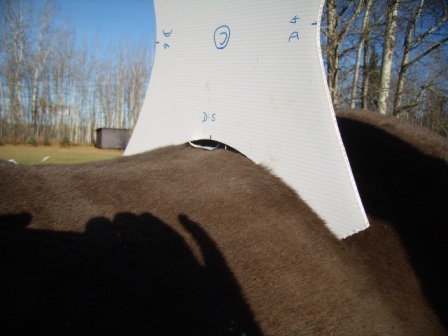

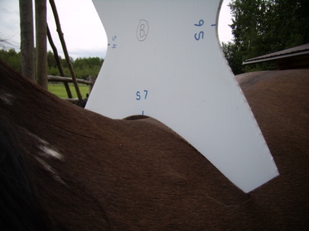

6.) Take one of the cards for the B position and place it on the horse's back at the B position you have marked. You are trying to find the shape that most closely matches the shape of your horse. Record this. This one obviously doesn't fit.
But this one does.
7.) Do the same for the C position. In all cases you are looking for fit all along the card, but especially where the bars fit on the horse's back. This one still has some clearance, and the ends stick in a bit.
This one fits.
8.) And the A position. This one seems to fit well down below, but the shape is wrong up top.
This one fits.

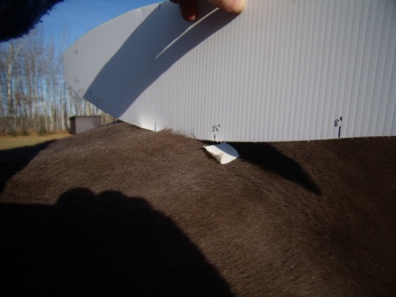

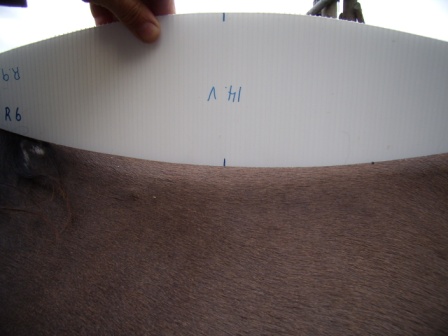

11.) Place the rock patterns perpendicular to the horse (not vertical compared to the ground) along this line 3 ½" off the centerline. Make sure the center mark on the pattern (marked 14 V) is at the B position. Keep the horse as square as possible with his head in its normal "working" position. You are trying to find the card that most closely matches the shape of your horse. Record this.
If the card has too much rock compared to the horse, it lifts off the back. Too little and the center doesn't meet, as in this case.
This one fits all along.

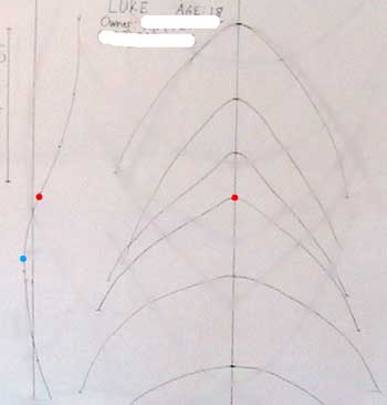

I have attached pictures of two horse's and thier back tracings. In both I have marked the 14th vertibrae in red and the low point of the back in blue.
Clearly when you look at the horses they have not been ridden by a skilled rider. Their conformation has been altered. Do you fit that or what their body should look like? If these people used this system would they properly identify the indexing point. Maybe my reference is scewed because I don't do much local buisness and for me I need to get information from a thousands of miles away so for me I need a system that has checks and balances so I can make sure the client has done it properly. Your client is the saddle maker and they can probable make the correct judgement calls.

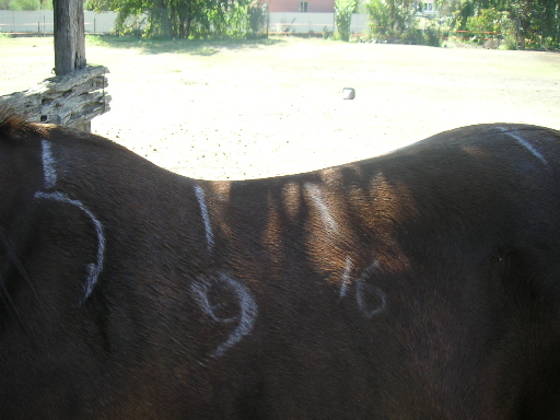

Put some chalk marks at the T16 and the T9 or whichever were the last that could be determined. Now estimate where the T14 is.
In this photo I have marked:-
- T3 at top of the wither,
- approximately around the edge of the cartilage elongation of the scapula,
- T16
- The gap between L6 and the sacrum. I think there is actually a name for the gap, someone help me out here.
- T9 is also indicated however it is actually slightly further forward than it appears in this photo. Angle of photo combined with angle of the line which I drew have distorted somehow.
The point is:- Between T9 and T16 there is T10, T11, T12, T13, T14, & T15, 6 vertebra and T14 is 2nd from the rear. Further rearward than what you first think.

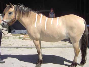

Note that the horse in this photo is precisely 14.2 hands high and has quite a short back even for his height.
There are several other accepted methods of determining the position of the T14. Pete Gorrell explains them very eloquently in the classes that he gives and the other methods are actually less involved than the one explained here, however, “off-the-top-of-my-head” I would not want to explain them without my notes for fear of making a technical error and to keep this posting relatively brief. All the methods concur about the position of T14.
In my experience, for the purposes of using Dennis Lane’s cards, an inch either way doesn’t change a category into which a horse fits best. There is just not enough “twist” in the contour of the horses shape to jump it from one category to the next within a few inches movement from front to rear.
As and indication, here is a superimposition of the “S” cards for the profile at T14 (or cross-section B ) just to show the relative change in angle from one category to next.

Well Dennis, DaviD and Hank were here on Sunday last. We had about 3 hours of very enlightening discussions while we measured my three Spanish Mustangs. As was expected there weren't any new shapes among my horses, and the guys had the opportunity to measure two other SM's up in Wyoming as well with similar results. I did find Dennis's idea of where he would set the rigging to address the rigging issues I and others have experienced. All three men had some great input to give even with differing opinions. Bottom line the Equine Profiling Card System is very simple to use, and provides a wealth of information. There was a comment among themselves that I wasnt to certain I heard right. It was regarding a similarity of narrowness at some point along the back across the SM's they were able to measure. Guys when you get back could you share? I researched pedigrees and gait types of the horses logged so far and added this data to my own data log as if there is some similarity between shapes across a certain criteria it would be very interesting information to have. If not it certainly didnt hurt anything. The sad part as none of my horses were in proper shape or age, one was quite thin from being injured and raising a foal, another was 30 days away from foaling, and the other was an unbacked 3 years old very small stallion. The two that were measured up in Wyoming were saddle geldings from stouter built blooldines.
All in all the project of measuring SM's with Dennis' card system is taking off and I hope to have at least 100 horses measured. In a breed with a total registered number of 4000 (give or take a few) and a large number of them (approx 1000 give or take a 100) deceased foundation stock and another 500 or so under saddle age. Especially since our stock primarily trace to around 100-150 foundation horses. I still feel 100 measured SM's will give us a good baseline for our breed. There are a good many Colonial Spanish strains/bloodlines out there too that fall outside SMR stock who would add some interesting dimensions to the project. I have decided to run a parallel data log for those horses as well.
Right: Hank Statham holding The Spirit of Bear Paw (3 year old Spanish Mustang stallion)
Middle: DaviD Morris holding a profiling card
Left: Dennis Lane
Anyway, Thanks guys for a delightful visit and for sharing your knowledge and open minds. It was a monumental day for Spanish Mustangs. Hank, I cut down all the tumbleweed and sagebrush it being a fire hazard and all. lol
;) S
