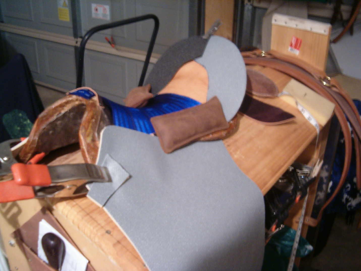

Attached is a pic of a stirrup bar on an Australian stock saddle tree (Fouright tree). One would be fairly easy to make if you decided on attempting another. This way you don't need to source another English bar and can dispense with the one with the spring loaded catch.

P.S Pic one is a stuff up and was added by mistake but it is the same tree as the bar pic.
