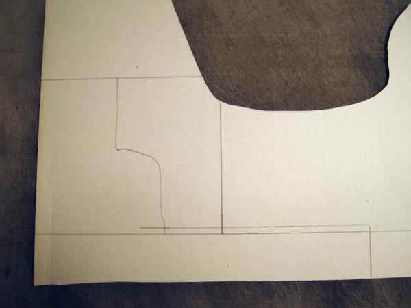

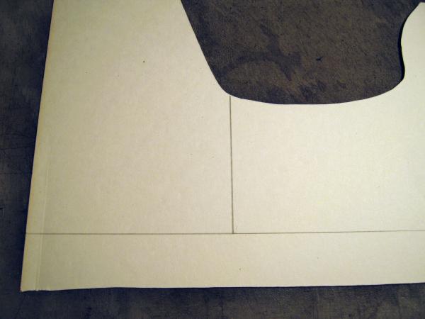

Photo one: First I establish a base line with a 90 degree verticle line on a piece of posterboard.
Photo two: Next I lay the pistol or revolver, in this case a P7PSP, with the top of the slide right on the verticle line and the muzzle flush with the baseline. Then carefully outline the triggerguard to the muzzle.
Photo three: Now just above the baseline 1/8 inch I draw in another line parallel to the base line. The purpose of this is that with some holster designs I want the muzzle flush with the end of the holster and I will use this higher baseline to register on the bottom of the holster. On other designs I want the muzzle recessed 1/8 from the end of the holster and use the original baseline to register.

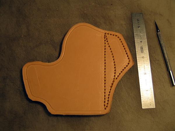

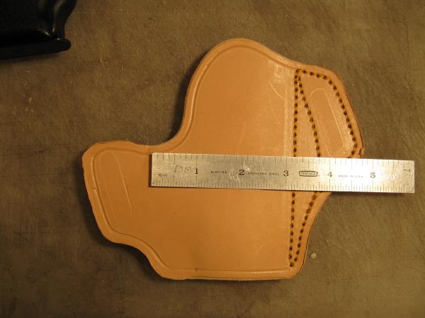

Photo four: Getting a little ahead of myself I use my stitchline pattern to lay out my glue lines on the inside of the panels once I have established the measurements to follow. I'm kind of fussy about gluing as much of the panels as possible. One of my pet peeves with holsters is seeing a separation of the panels in the belt slots.

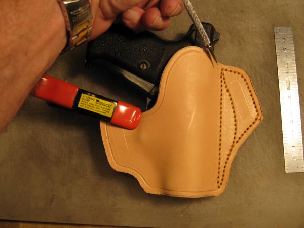

Photo five: Here I've glued up the two panels and stitched the outer one. Then I insert the gun and push it as far up against the slide stitchline as I can and place a spring clamp as close as I can get it to the triggerguard.
Photo six: Now since the leather isn't wet I can't get as close to the slide stitchline as I want so I measure the gap between the top of the slide and the stitchine. That is where I am pointing with my stylus. In this case it was 1/4 inch. I take half of that measurement, in this case 1/8 inch and mark that much ahead of the lips of the spring clamp in the perifereal stitch groove.
Photo seven: Now I do the same to the bottom again marking in the perifereal stitch groove.

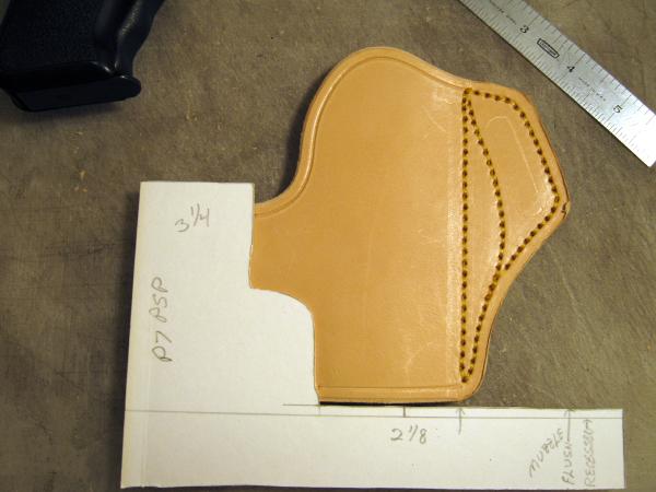

Photo eight: Now I remove the gun and flatten the panels out. I measure top and bottom from the slide stitchline to the dots. In this case it is 3&1/4 and 2&1/8 inch. I write these measurments on the stitchline pattern.
Photo nine: Now I use the pattern registered on the bottom of the holster to connect the dots.

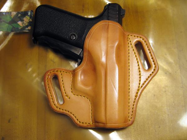

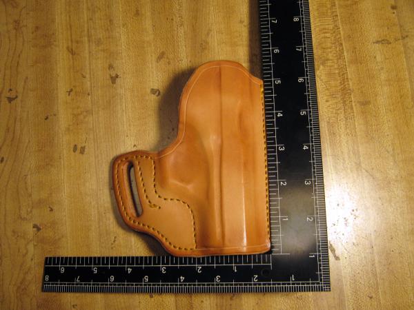

Photo eleven: Did it work? Sure looks like it. I can now use this stitchline pattern on future holsters by just measuring over from the slide stitchline top and bottom and connecting the dots with the pattern.
Photo twelve: This method as described requires the bottom of the holster to be 90 degrees to the slide stitchine. This is a normal method of design layout. It will also work for those designs that are not 90 degrees by adjusting the baseline.

Two final photos.
