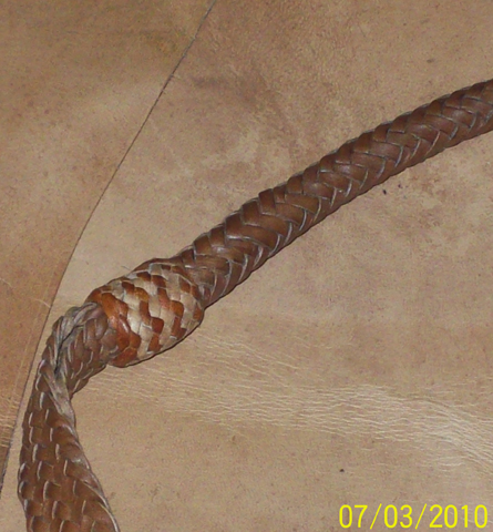

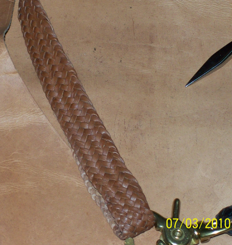

I made my first dog leash from calf lace.
post-1307-126800542777_thumb.jpgpost-1307-126800278115_thumb.jpgpost-1307-126800275612_thumb.jpg
post-1307-126800273508_thumb.jpgpost-1307-126800270858_thumb.jpgpost-1307-12680026976_thumb.jpg
That was the calf lace I first bought at Tandy.
Brian...
