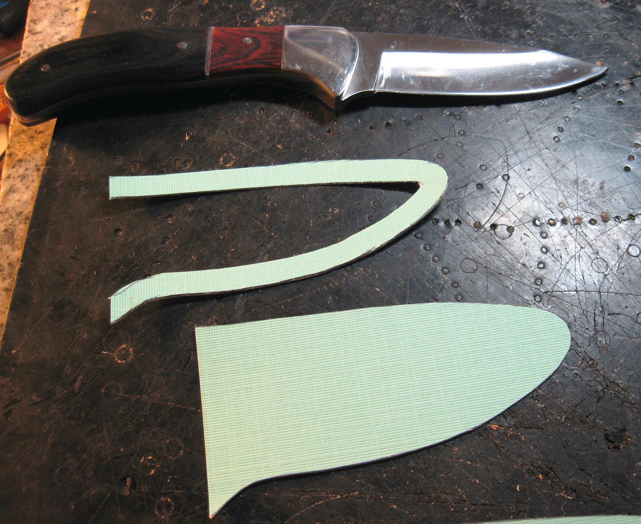

Trace the outline of the knife and then add about 5/16" to the outsideof it. This allows for some extra and allows for the stitch line.
This will be the welt,
Now trace the whole outline and add same distance for your overall pattern for both sides. You use one of these and flip it over for the other side. Make sure you do that if you want grain side out on both sides.

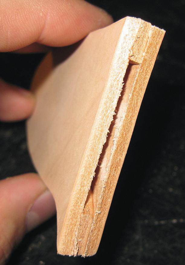

Use some contact cement and glue your cut leather together kind of like a leather sandwich with the welt in the center.

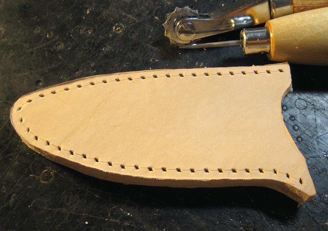

I prepunched on this one, I usually do on my sheaths, its just easier for me.
Stitch, dye, and finish your edges.
