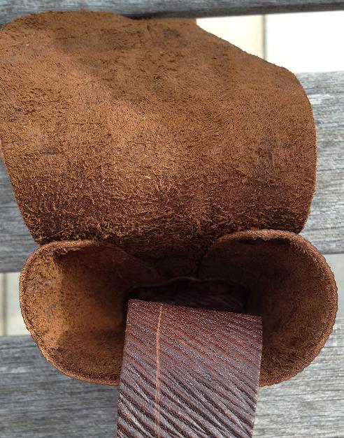

Hi Tenneal
Here is a pouch I made last week. It's an Australian Light Horse Pattern 1903 10 round belt pouch. The pattern was copied off an original made by Beckers of Brisbane dated 1916. These pattern pouches were also used on the 50 & 90 round bandoliers.
The pouch you made looks to be a cross between this pattern and the Patter 1915 webbing pouch. Australia did not have the facilities to produce webbing, however, they did have a well established leather industry. The Pattern 1915 gear was a direct copy of the British Pattern 1908 webbing.
Like you I laso had difficulty at first rivetting the bottom of the pouch, however, this was solved by using a cobblers anvil. The small shoe iron is a perfect fit allowing the rivet to be set.
I'd be interested to see the article from the journal you you got the patten from. I don;t have access to this journal in Australia.
Regards,
Mario

See below. [
Edited by Campchair
See if you can find an old (or new) railroad spike. Locate a bench grinder, and grind (or get someone to) the head so the side flanges are flat against the square shank. Take a turn or two across the head, (the part the hammer hits) and polish it up with coarse emery cloth. 80 Grit is fine, it does not have to be prefect, just get the rough areas out. Round the sharp edges while you are at it. To use, tighten the shank in a bench vise, insert the rivet with a pair of needle-nosed pliers down into the hole at the bottom of the pouch, and slip it over the "stake". Peening the rivet is easy, as you have a solid anvil under the head. I make "Safari" type ammo pouches and I've found this homemede "stake" tool, can reach 'way down into a completed pouch and is very handy to set those copper "burrs" (Rivets). I have made up several in different widths for applications needing a rivet set at the bottom of a sewed-up pouch, and have found them to be a lifesaver. There is a type Confederate musket cap pouch that has one copper rivet at the bottom, and it was a real pain to set. Now, it's easy with this tool. Campchair
