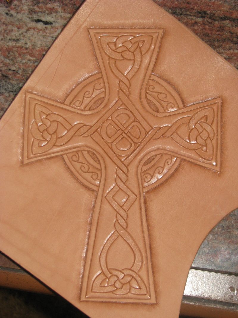

I started this little project as a test drive for a swivel knife, and decided to go ahead and bevel and dye it.
post-5374-0-24912800-1349837427_thumb.jp
And here's where I ran into a problem......I didn't get enough Resist/Block on the 'rope', and had some bleed through.

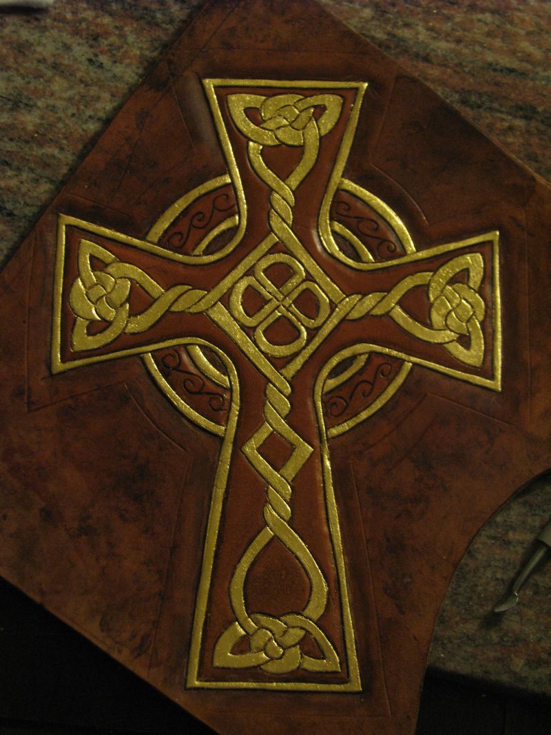

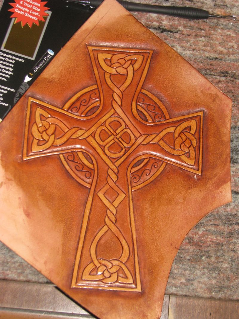

Since I didn't want to "dye it black", I decided that covering the error would be the best solution, but just painting it didn't seem to be enough. So......I went with the MUCH LONGER process....
post-5374-0-39316200-1349837659_thumb.jp
If you didn't know it, gold leaf that doesn't go exactly where you put it, well it comes off it's sheets in little flakes. If you don't have it stuck down, the little flakes go EVERYWHERE. And if they get in a place you don't want them....it's a nice afternoon eating project to pick off the little flakes that don't want to brush or blow off.
However....I think the result is well worth the effort. I originally set out to just complete it, and now I think I'll cut it out and mount it on proper background.
Incidentally.....this is not actual gold leaf.....I'm a poor, broke, leatherworker after all.

And the last pic is take with no flash. That's just reflections of lights around the room.
Looks great!! I don't have your patience, it would have been USMC Black if I'd done it. This is way better.
