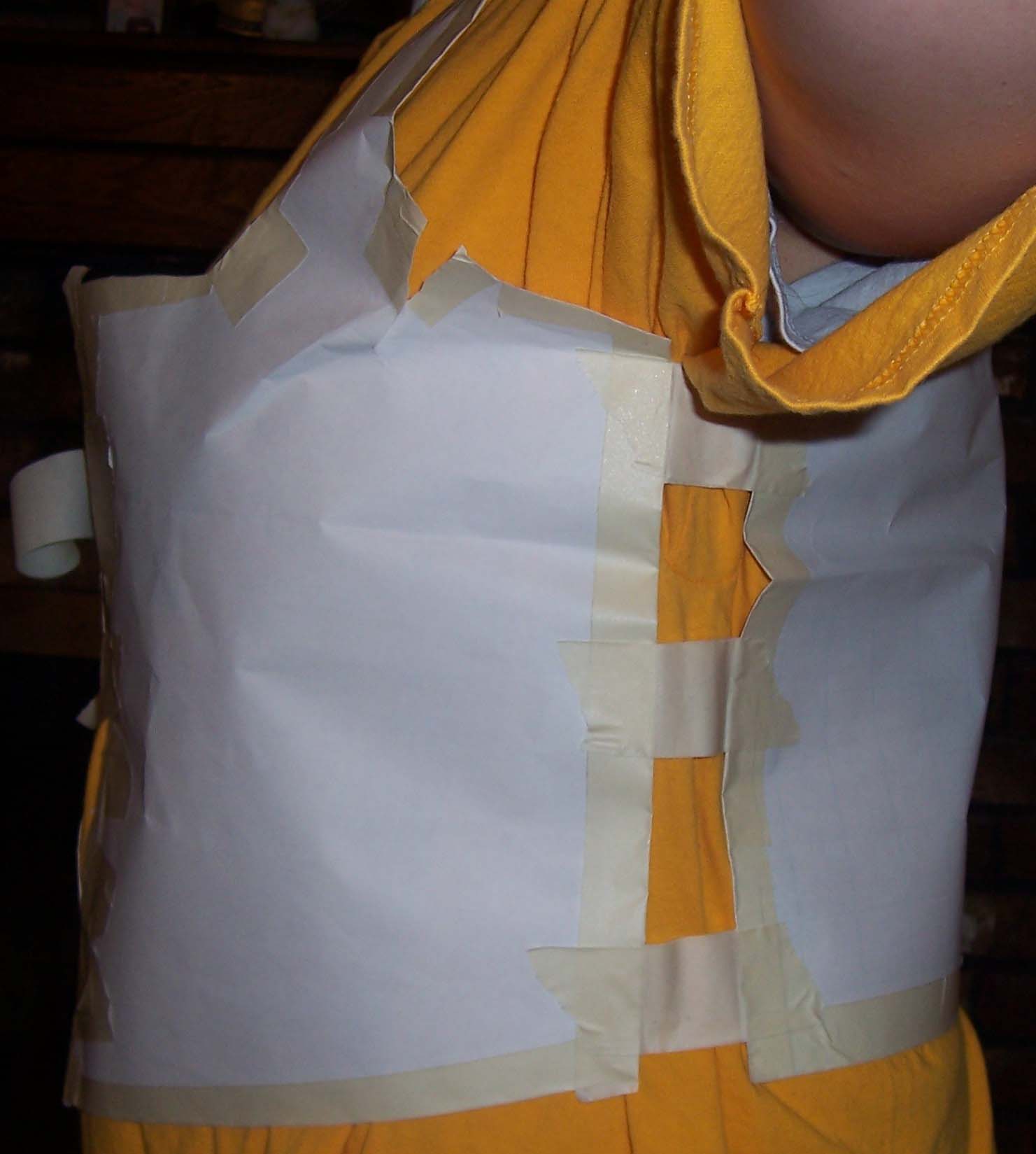

Here is a pic of one of the young ladies in her paper and masking tape corset. You can also see the pic we were working off of. This is one they found out on the web and we are using as a model.
Mearsured them, drew the measurements in on the pic, drew the design out on large flip chart graph paper and the cut it out and started taping....
Once we got the size right, we cut it into the back panel and the two front panels and then laid it out on the suede and started cutting.....

I hate to say it, but you're not going to get anything close to that shape out of your leather pieces by fitting the girl so loosely and using paper. That's a corset, and they're *not* easy. The best way to make a custom pattern for a shaped garment like that is with a duct tape fitting: http://www.thedragonsrobes.com/taping.html
Also, before you cut the leather, do a mock-up of the pattern in some non-stretchy material. That way you won't waste the leather, but you can work out issues with shaping the pattern pieces. Also, you're going to need to bone it. There won't be any support with just suede -- it will buckle and fold and not have that lovely smooth line.

I had thought of the duct tape method as the link shows, however, as three of the four ladies are underage, we are not going to make them that tight. Their parents want the items to enhance their outfits....not them, if you understand my point. I will be using the duct tape method when I make my wife's corset.
The forth one is a mother of 2 and built about like the model in the taping pics and she wants to go more of the tubular bodice look, but a tight corset. She is also a seamstress, but has never worked with leather, so she is helping with some of the points you made as well.

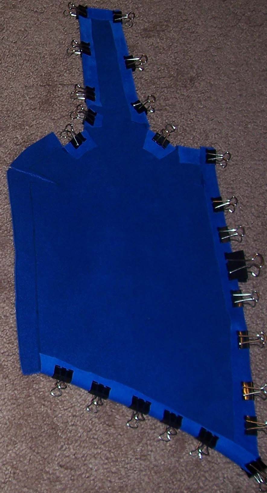

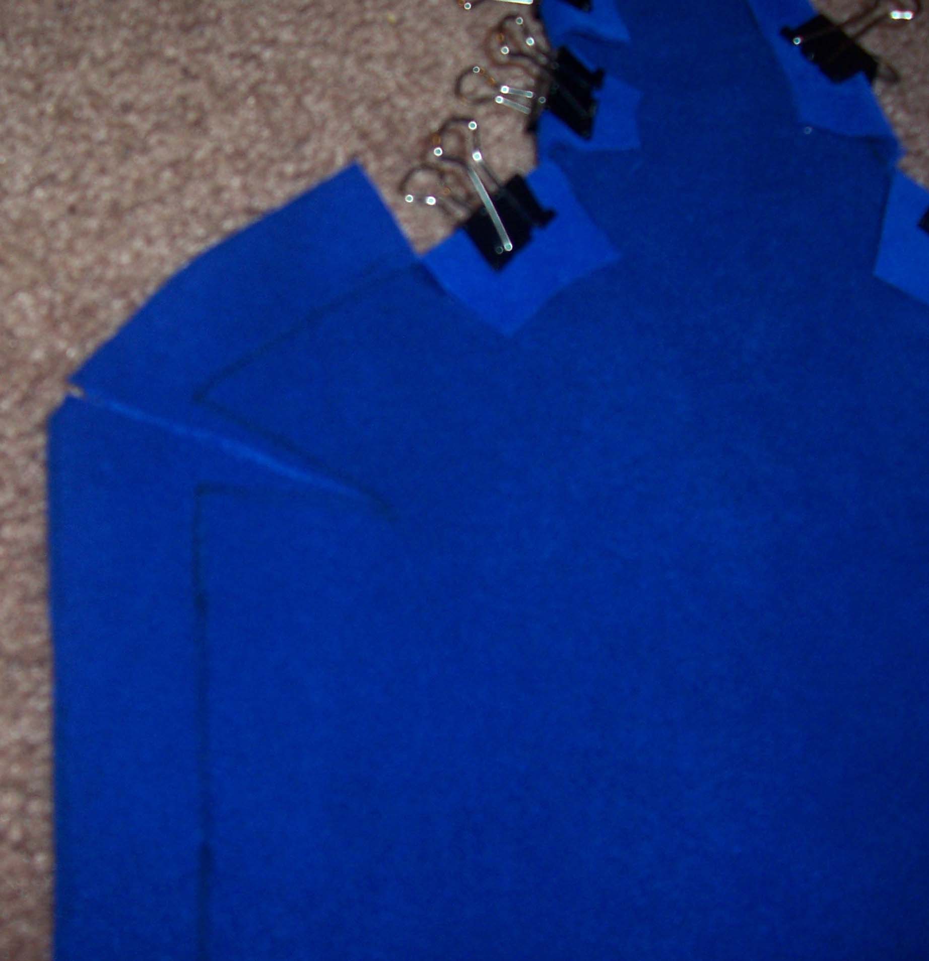

After they got the paper/tape models all done, they cut them apart and traced them onto the leather. I had them add a 3/4" border outside that then cut them out. They folded the border over and glued it down to make a reinforced edge. The grommets will actually go thru this border later.
Below you will see pix of the border/edge, the inside and outside of the back panel and inside of the front panel with the clips holding it all together as it the glue dries. There are a few spots that need trimming, but it is an work in progress.....

I understand what you're saying, but there is a difference between "tight-fitting" and "well-fitting". The duct tape would have given you a well-fitting garment, if you made the pattern with enough ease.
