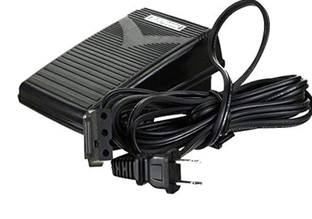

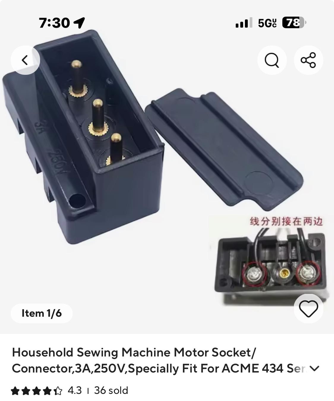

  1. I have a reliable barracuda 200zw (similar to a sailrite 200zw) It has a flat asymmetric pin connector for a classic foot pedal/ac power connection to the external machine-mounted motor. I am designing my own replacement speed controller and want to use the existing connector. I know I can buy a wired pedal and cut it but for ease of experimentation I was hoping to connect wires to a banana style or pin jack. To plug into the existing motor Lowe without cutting wires. I don’t know the size of the pins/sockeys. AI says try 2.8mm and then 1.5mm but I’m not convinced it’s right about anything. Im not near the machine. photo of the typical connector foot controller (female connector) https://a.co/d/fpXFvPf machine side connection:Socket connection (male pin) https://a.aliexpress.com/_mtRUCn9
