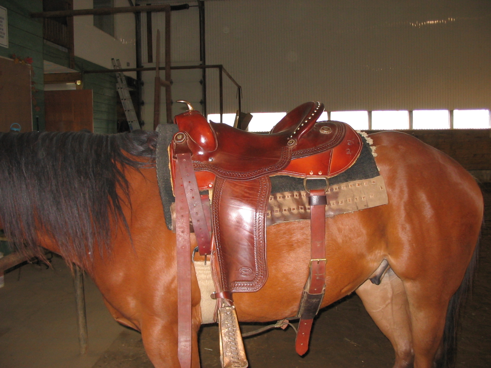

This one was a few years ago- it was my first in skirt rigging, my first rawhide cheyenne roll, and my first braided welt. I ride this one a lot starting colts and training- I couldn't get the cowboy out of me completely, so consequently the bowman reining type tree with strings and rawhide! Any feedback much appreciated! Chuck
