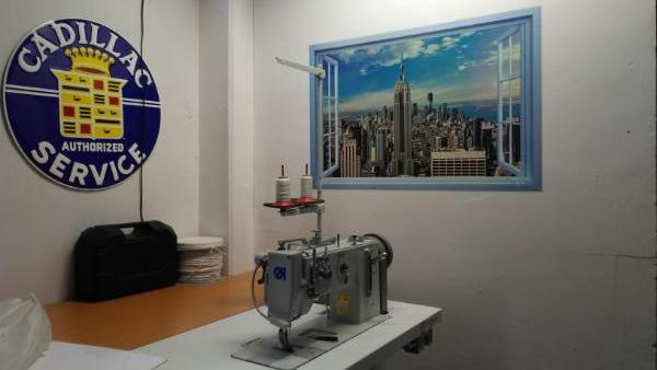

  7. im an old pro. ive had a upholstery shop for 15 years. back then i bought a new durkopp adler 267. i used that machine without issues all that time. but i was moving and sold my house and workshop. then the sellers of the new place upped the price with 50k so i had to shift my focus to storage. my house and workshop is packed in 4 20ft containers and i have a old farm shed storage hall. as im looking for a new place. 4 months in and bored waiting to find my new place. i thought lets buy a little machine and do a little work. small budget as im paying rent and storage fee,s this one was suposed to be working just needed a little maintenance from sitting a few years. sadly i was mistaken XD so i just wanna get it running and make little projects i can sell again. i cant unpack the storage containers so i have been buying little things here and there to set up a temporary workshop. i have black red and orange thread at the moment so i can do 2 color. ill get to it tommorow again hopefully
