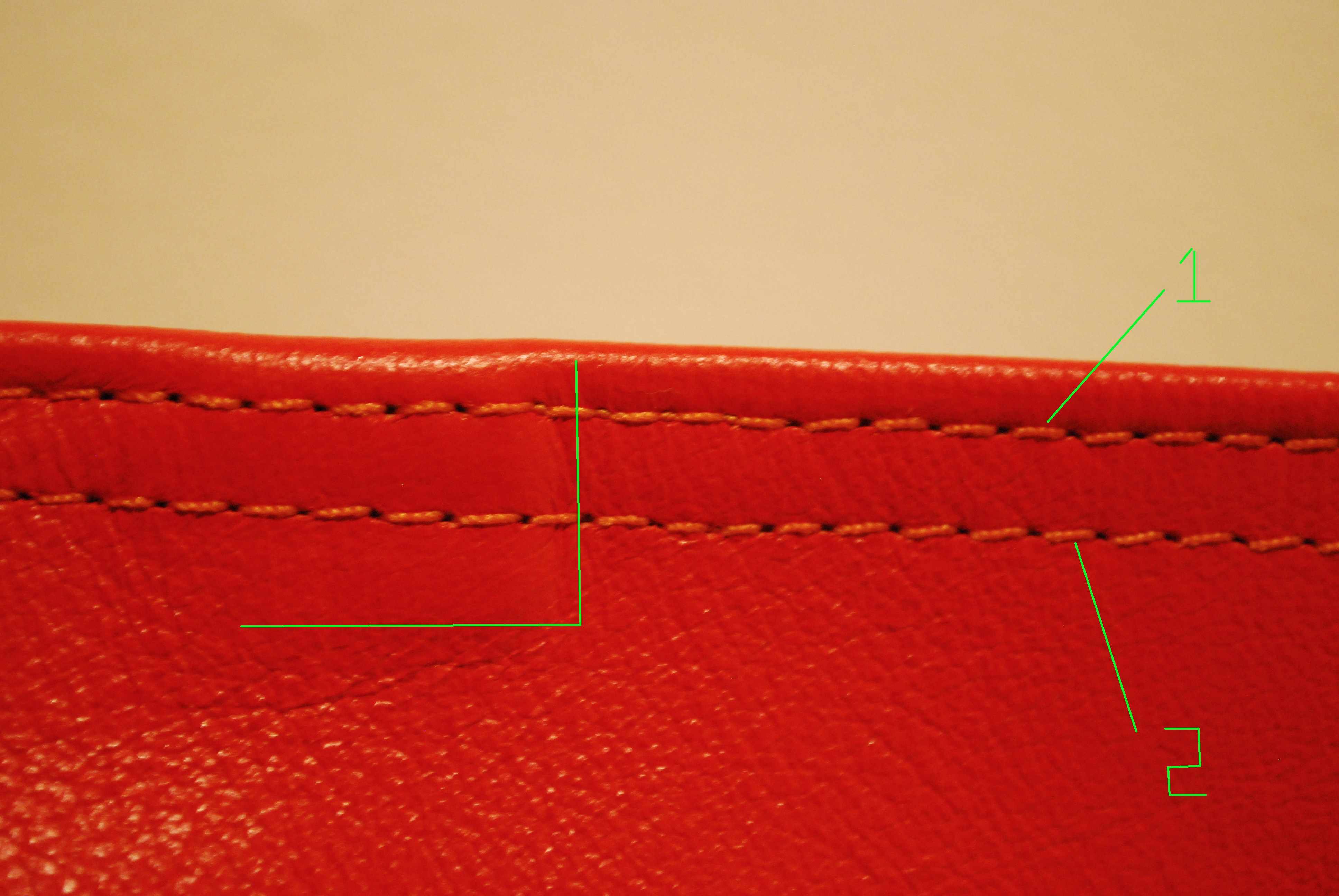

  2. Kevin - I think there is enough pressure on the presser foot so i've kind of eliminated that one for now Ferg - Although im using tape from time to time i tried what you suggested and eliminated the tape and used a new needle but still no difference. Art - If anything most of my stitching is very slow so its definitely not over heating. Ok what i've done is attached some pics of 2 stitches where ive simulated the problem area by stitching over an additional 2 layers half way down the seam as indicated by the green lines. The first pic clearly shows the underside thread showing through after the foot passes over the high point of the layers while the second stitch shows the result of loosening the top thread, although not bad on the top the second pic of the underside shows what happened to the bottom stitch. One thing i have noticed is that the problem only happens when the foot is coming down off the higher layers of leather so what i mean is that the back of the foot is still elevated on the 4 layers of leather but the needle is actually stitching 2 layers - that is when the bottom thread shows through. Should i be using a different machine or foot for this type of top stitching work? Thanks for your previous replies, i really hope i can get this thing fixed!! Kenny
  3. Hi All, Just wanting to get some opinions from those more experienced than myself. Im sewing soft 3oz leather motorcycle jackets with a Mitsubishi walking foot machine. The issue im having is that i'll set my thread tension to sew a 2 layer seam but as soon as i hit another seam join where it may go from 2 layers to 3 or 4 layers then back to 2, im getting a change in tensions and the bobbin thread comes up through and is visible from the top. It looks terrible and i cant seem to find a way to fix this issue except by altering the tension when i reach these points then re tensioning after they have passed which is really just pot luck. Is this normal or should i be able to vary through multiple layers and achieve a nice even stitch the whole time without touching the machine in the process? I hope this makes sense and i'd love to hear any suggestions you may have! Thanks in advance Kenny
