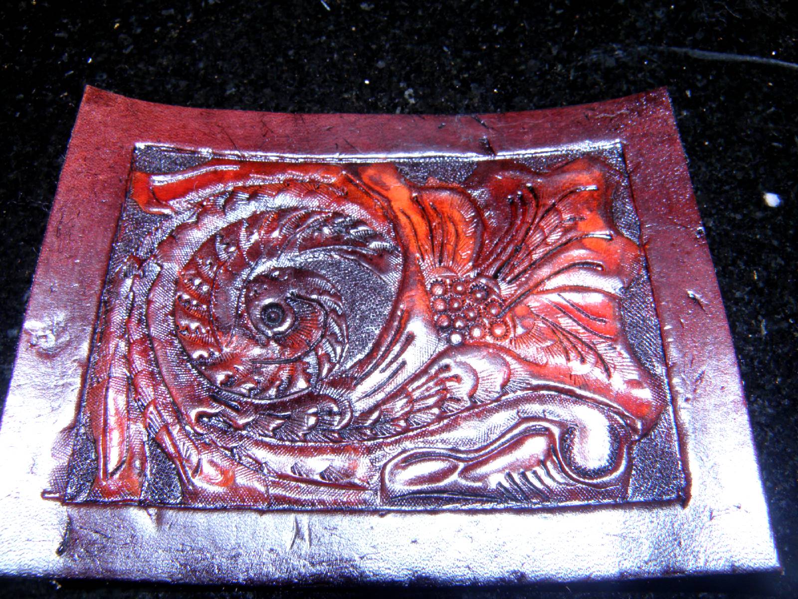

  9. I wanted to do a resist finish with the flower an scroll work with Fiebings British Tan followed by Eco-Flow Mahogany Antique gel. I figured it would give the carved portion a nice burnished look against a darker background. So I paitnted the flower and scrollwork British Tan followed by Super Sheen as a resist. The results were less than impresive: (see Wrong.jpg). Only the tip of the flower came out as it should. Super Sheen didn't resist anything. So what to do? I went online to Springfield to buy a product specifically for resist dying. I figured the problem with super sheen was that it was water soluable and so is the gel antique which must have simply pushed the super sheen out of the way. I was all ready to purchase the resist product when an idea occured. I make models as well as doing leathercraft. Modelers use Future floor finish for all sorts of things. Turns out a bottle of Future is simply a huge bottle of pure acrylic. Would Future make a good resist? It dries a hard acrylic gloss the gel antique should not be able to get through. So I gave it a try on another practice piece. First the british tan onver the flower and scrollwork, followed by a coat of Future. It worked perfectly (see Right.jpg): It also worked as an overall finish. I bent the leather severly and there was no cracking or "whiteing." So, give future a try. Like I said before, it's just a big bottle of pure acrylic gloss -- no soap or other ingredients. It is a good resist and a good overall coat -- its flexible and strong.
