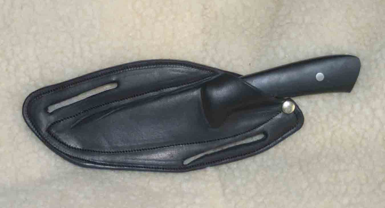

  1. OK after a bit of playing with the design i came up with this not 100%happy with it but the client loves it so hey i guess it is OK the problem was the knife was so long at 10" and heavy to well i did my best

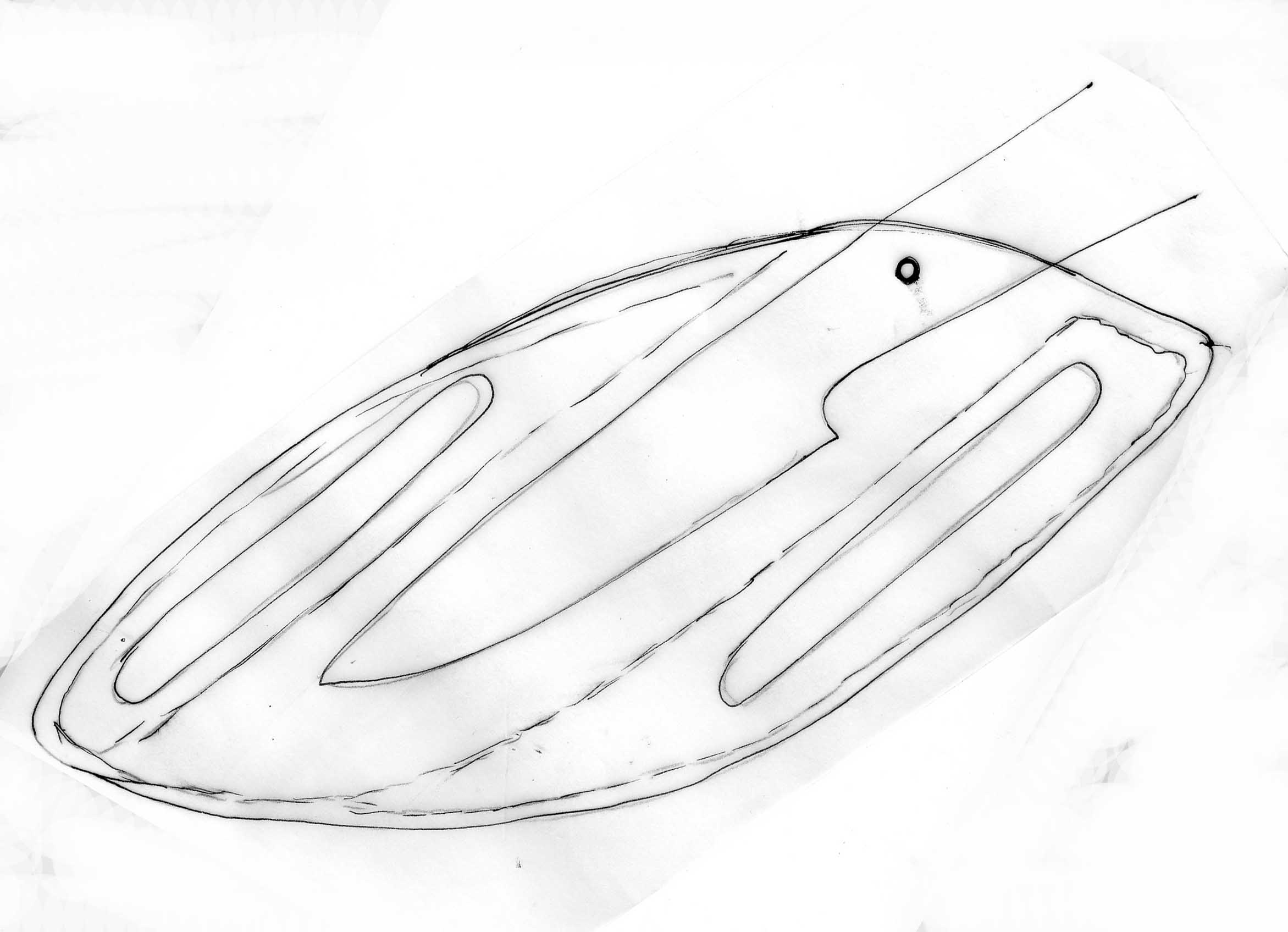

  2. the way i thought about it was to make 3 layers on the belt loop side so you would have backing a thicker center skived away to the belt loops with the center cut away and to protect the stitching and then a top leather this is the basic line drawing i have com up with the main problem is the knife is very long a 9.5" and very unbalanced the main worry is that the knife and sheath must be comfortable to both wear and use that's why i have gone for the oversize belt loops to give some degree of movement
  3. i have been asked to make a sheath in a cross draw pancake style edge down on the right side the knife is 91/2" in length with a 5" Blade any help pleas lads i need a pattern to follow thanks
