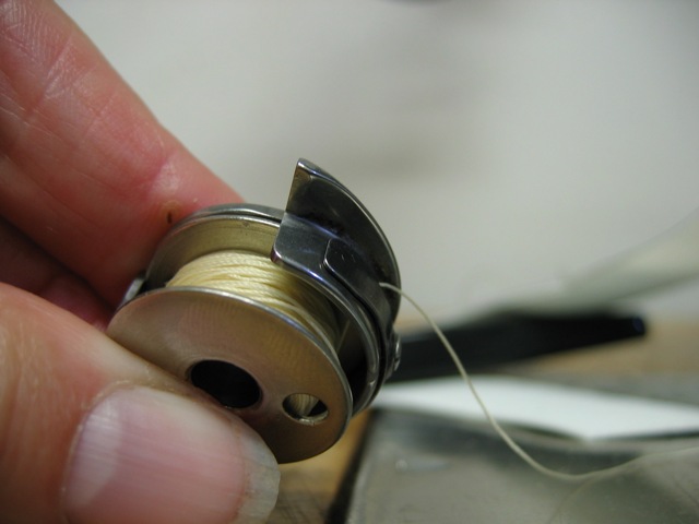

	Success! I mentioned all the things you folks were suggesting to my husband. Today while I was out of the house he looked up "how a bobbin works" on the internet so he could understand what it was supposed to do - he has no sewing experience. He then removed the lower bobbin mechanism and cleaned it all. He said there was a lot of thread jammed in there. He checked to see how it all worked and then adjusted the needle height so it would line up properly with the bobbin. He opened up the machine to adjust this - not just the needle and the screw to hold it in place. It works! When he looked at it last night I was hovering over him and giving too much advice:....... - he said he just needed some time by himself to study how it all worked and fixed it. Thanks so much for all the help folks!
	I will try your suggestions before I give up and bring it to the repair man. Thanks so much.
	I have the manual and have gone over it numerous times. Threading it by following the diagrams and making sure the needle is in correctly. I will look into the clutch part. I have noticed that the bobbin holder goes around but does not pick up a thread. I am going to try a few more of the sugggestions and get my husband to read these comments as well and see if he can help me as he's more mechanical than I am - although he has no experience with sewing machines. Thanks everyone and I will let you know how it works out.

	[Yes,a pic might help. Bob Hi Bob. I have attached pictures to show how I have threaded the machine and bobbin.
	Yes, I am threading it from left to right. The walking foot has a hole right under the needle and I have tried putting the thread through the hole and also without putting it through the hole and just through the needle. I am also turning the handwheel towards me. I have tried it with the foot lowered and with it up. Should I try taking pictures of how I threaded the machine and email them to you? Also, I could email a picture of the bobbin and how I inserted it. Would that help?
	I probably should be more clear on my bobbin thread problem. I have rethreaded the machine and inserted a new bobbin into the holder. At this point I am unable to get the thread caught up from the bottom of the machine to the top of the machine to begin sewing. I have the needle in the correct way according to the manual facing left with the long groove. I hold the top thread lightly in my hand and turn the wheel where at this point the bobbin thread should get picked up when the needle goes down and up again but it does not. I'm pretty sure it's something simple I have done wrong but I do not know what.
