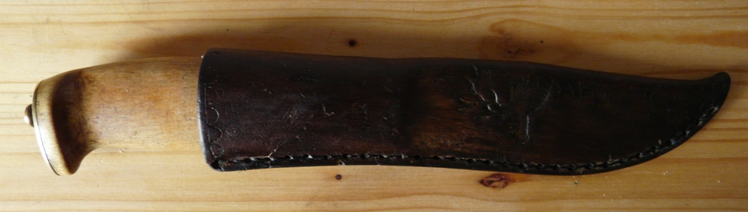

  1. problem solved. went for option #1. skived a piece of tooling leather as an inlay and glued it together, then just sew it back together and burnished/coated the edges. then i waxxed the hole thing. the customer was happy, even though i had no leather in matching color or dye left.
  2. Hey folks, i've got quite a problem lying on my workbench: a friend of mine wants a 60-70 year old knife sheath to be repaired/restored. it's ripped at the entry, just within the sewing channel and needs to be resewn. normally id simply make a new sheath, but he wants it for the vitrine, so at least it doesnt have to withstand as much as a sheath being used daily. i thought of 2 options: #1: skiving the inside of the entry area a bit and then glueing in a really thin leather inlay. the old leather probably wouldnt survive the skiving because its really dry and the rip would still be visible/open up again while resewing. #2 making a really thin strip of leather to put and glue over the ripped area to cover maybe the first 4-5 holes, approx. 0,4'' wide. would work but change the look and it would be a visible repair. any ideas? i really dont know what to do with this cheers, Jan

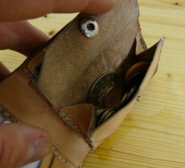

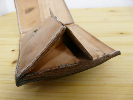

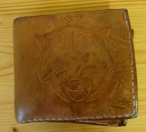

  3. hey everyone! about one year ago i started off with working leather, because i couldnt find a proper belt and wallet in the shops. i had the crazy idea to have a wallet, belt, knife sheath and pocket knife pouch out of one hide. so i got myself a cowhide and started.... i think it might be intresting for some to see this kinda wallet, because if never seen anything similar so far made out of 3mm tooling leather, even though the work itself is really bad, due to being my first project. the only tools i had at this time were a cutter knife, a ruler, the awl on my swiss army knife, punch pliers, a skiver and one backround stamp (and needles, wax & thread of course). i also didnt put any finish on it... so it already looks quite aged. the hardest part was thinning the leather. used a hand skiver to get it down from 3 mm to slightly under 1.. took ages the "carving"(if you can even call it carving) was done with a cutter knife, a backround stamp AND the ear of a needle i decided on remaking some of the same kind now... using proper tools and better skills. i will most likely use bellies this time, cause i cant afford a splitting machine and they're the thinnest option. even though the work aint good i love the design & functionality of it. any ideas for improvement except for simply working better? cheers

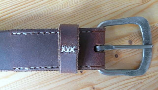

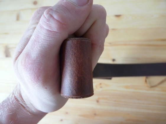

  7. hey folks! finally i get to post my first couple of pictures in the show off section my little sister had her enrollment ceremony for primary school on saturday, so i took friday off and spent a bit of time one putting together some presents and making a proper belt for myself to wear. the pencil case is made of veg tanned sheepskin. the pouch for the swiss army knife is made of natural veg tanned cow hide and has been treated with some bag kote and atom wax. the belt is made of dark brown buffalo leather, which has also been veg tanned and has a nice pull-up effect to it. that means it gets lighter when flexed. a highlight is the handforged buckle, which was made by a friend of mine. everything has been sewn with artificial sinew. critique and suggestions for improvement wanted
