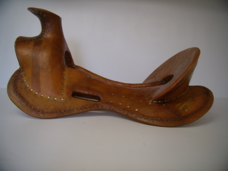

I just recieved from Denise Nikkels a photograph of Paisano's tree that Rod built. It was shipped from Canada today. I will be detailing how I may go about building the saddle but the actual build won't be underway until fall or winter, however I will be working up a prototype of what I want (without nails, glue, tacks, etc) whereby I can use the tree on Paisano this summer to see how it is all going to come together. Don't worry folks I will make sure everything is lined up exact as if it were the final saddle. More on the tree can be found here: THE PONY EXPRESSION I'll be hitting you pro's up as I go along for advice if you don't mind. S Just a beautiful piece of craftsmanship. Thanks so much Rod and Denise, you guys have been wonderful to work with. I have to thank Dennis Lane and DaviD also for the time they spent with me last summer during their visit to the States.
