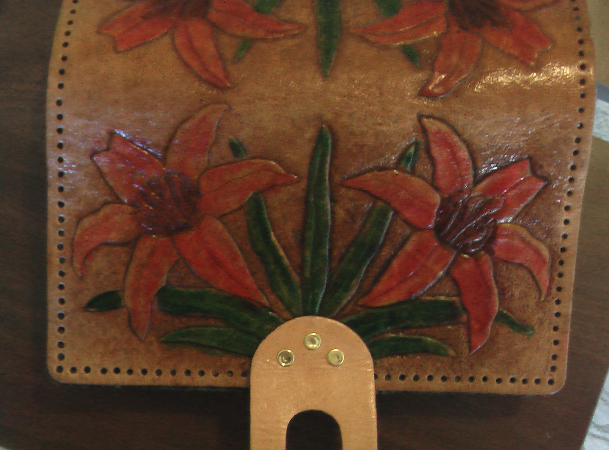

Teresa. We love that country down your area , I get all my gear from { http://www.tandyleatherfactory.com.au/en-aud/home/home.aspx } I joined their elite club and get around 30% off most stuff . they are fast and very polite as well helpful . They have a free call number you can call to ask questions , Tell em Ron from Mudgee sent ya lol . I have just put a handbag into our local show and got 2nd prize .. Send me an email and we can keep in touch ronnbarb9@bigpond.com . I used to deal with Birdsalls but found they buy from Tandy then sell it to you, so you know what that means hey. They gotta get a bite of the cherry too .. So I've cut out the middle man . Cheers Ron
