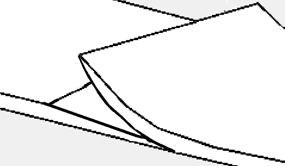

  2. Hi everyone. It's been a while but i'm back.... still trying to figure this issue out. Any suggestions would help a lot. I've tried to skive the ends of 1/2" wide traps on a traditional skiver but it just eats up the strap end, leaving a less than perfect skive. There's probably not enough mass to feed it across blade.

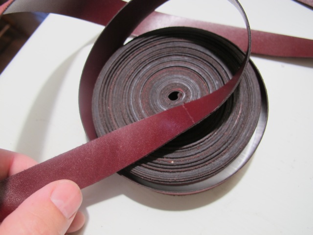

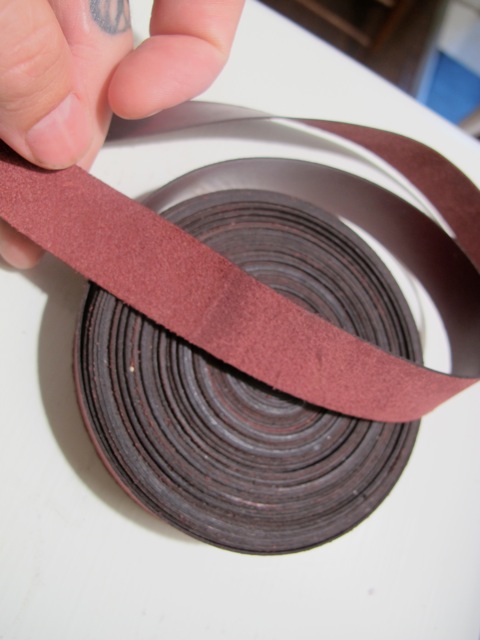

  4. Here are the pictures. If you look closely you can see where it's joined on the front and back. I've found companies who do this service here in Los Angeles but they don't want to give up their secret, understandable so. Thanks! -Ben
