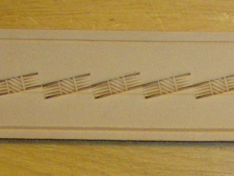

  6. In one of the Basket weave threads somebody suggested saving and reviewing the Mosby Tutorial before starting the project. GOOD IDEA! I wasn't paying attention on the attached photo and didn't line up the stamp correctly. The good news, (Iguess ) is that I was consistent across the first line so I am thinking it is salvagable. I just can't seem to come up with something that looks good. I have been working on some scrap pieces so you won't see the efforts in the thread. Any suggestions would be greatly appreciated.
