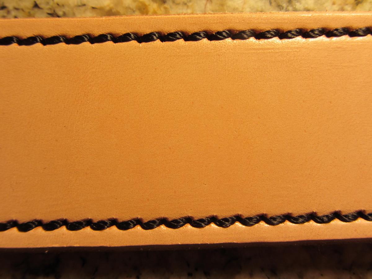

  1. The leather wasn't damp at all. Although I do wonder if the leather may have been too dry? I live in MN, and during the winter here it is extremely dry. The cold weather freezes the moisture in the air. You guys think that could be a cause? And if you have the info, what do you keep your humidity level at in your shop?
  2. Shouldn’t be a leather issue. This is from a b grade Hermann oak back that I just bought. I dampened the leather and slicked it down which worked really well. Being a nube to sewing machines I wasn't sure if there was something that I could adjust on the machine. Not sure if you can adjust the height or pressure that the walking foot presses into the feed dog. Do any of you do this? Changing the height or pressure of the foot (the one that the needle goes through) as you sew different thicknesses of leather?
  3. Thanks for the info guys. Yeah I think I might try a smaller needle. this one is a size 25 with 277 thread on top and 207 on the bottom.
  4. here's the top side
  5. So I finally got my sewing machine. I've been stitching holsters by hand until now. I got the machine set up (toro 3200) ran a few practice peices, and then stitched up a concealed carry belt. the stitch looks great on top. nice and even and about level with the surface of the leather, but the back side (I line my belts) has a rippled effect caused from the hollow in the feed dog. So to all of you sewing machine junkies out there, is this a normal look, or is there something that i should adjust??
