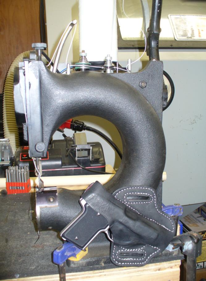

Update: Just got back from a trip so haven't had time to post an update. Anyway, I received the machine as promised and it didn't take much to get it into operating condition; just a bit of grease on the working parts, some fine tuning on the thread tension, and a longer bolt to attach the stitching handle to the gear shaft. I attached it to my work bench with a couple of clamps and off I went. Included is my first holster – made for my AMT 45 Backup. Its not fancy, but it serves the purpose much better than the cloth inside-the-pant holster that I had. Thanks again to all for taking the time to read and respond. Happy leathering. (probly not a word but what the heck) Mike
Update: I received the machine from the owner in Oregon. It arrived in the original wooden packing crate along with some accessories. Now to spend some time checking it over and familiarizing myself with it's function/operation. Luckily, I was able to download an owners manual from the Tippmann site which will help a lot - but more useful was the web site's instructional video which showed thread tension setup and some other handy tips. The only thing I noticed initially was how the stitching handle is attached to the shaft. It's only held on there by one 3/8 threaded allen head bolt. Doesn't seem heavy duty enough to handle the torque when operating that handle... I went ahead and installed a longer bolt which threads into the gear shaft just a bit further. More to come as I delve into this further.
