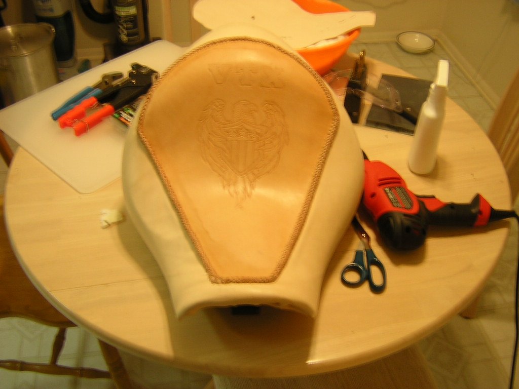

  2. I have an R but I am doing a C seat for a buddy now. You can see some of the mistakes I amde here on mine it looks ok but not good enough in my opinion. As far as the patter that was tuff in the end I went to ebay, bought a couple stock seats cheap (between 30 and 50 bucks) and cut the stitching and made my pattern on light card. I need to make another as I am currently re-doing my first attempt. hope this helps man Dunc
  3. THis seat is very close if not the same as my honda VTX 1300 seat I have. I am in the process of re-doing mine after much consideration I am going to mix the two styles (Daves and Beeza's) Let me explain... I am going to lace the seat front to the piece that covers the back top of the seat, where the stitching is now. I will tool the top seat and I think I am going to basket weave thr back top piece. Some things to consider... Don't put your lace underneath you as a rider this is just painful after a while and cuts off circulation. Pay special attention to the number of holes you have on your laced sides, if they don't match your seat wil not come out right. Use beeza's method for securing the seat to the pan with pop rivets. hope this helps Dunc

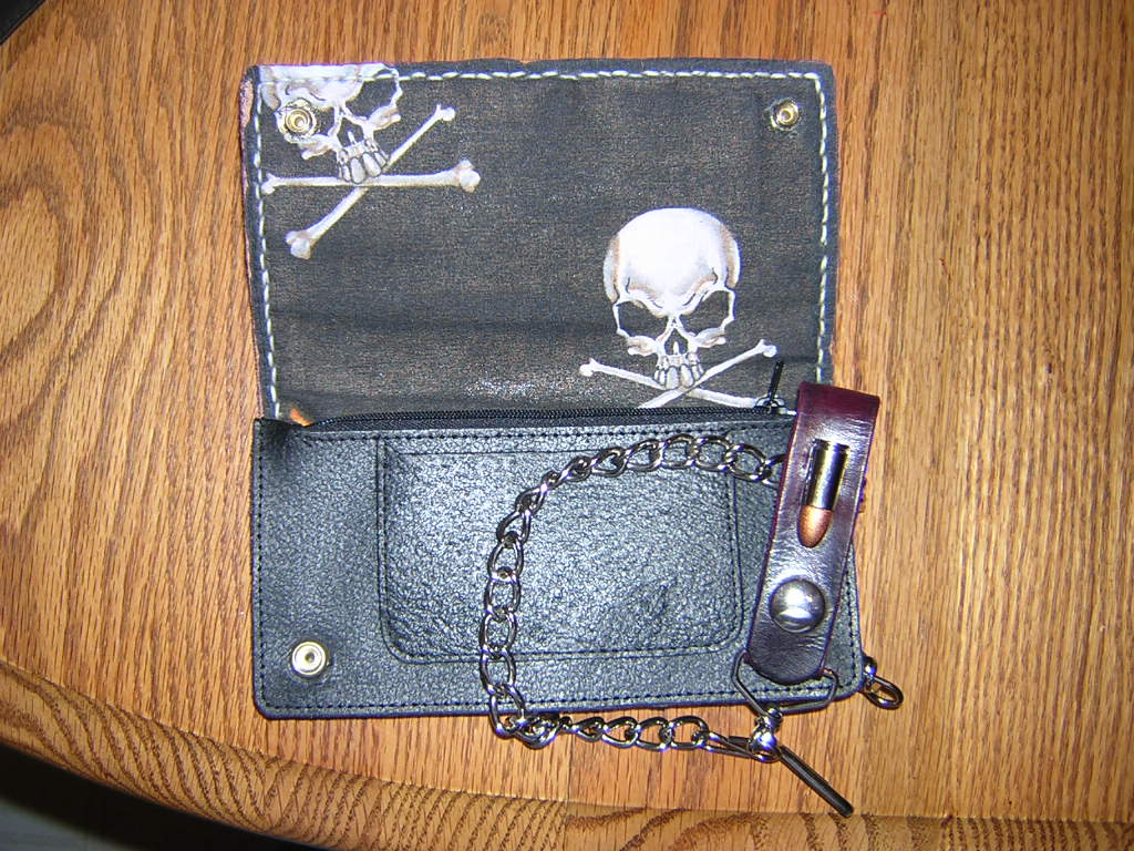

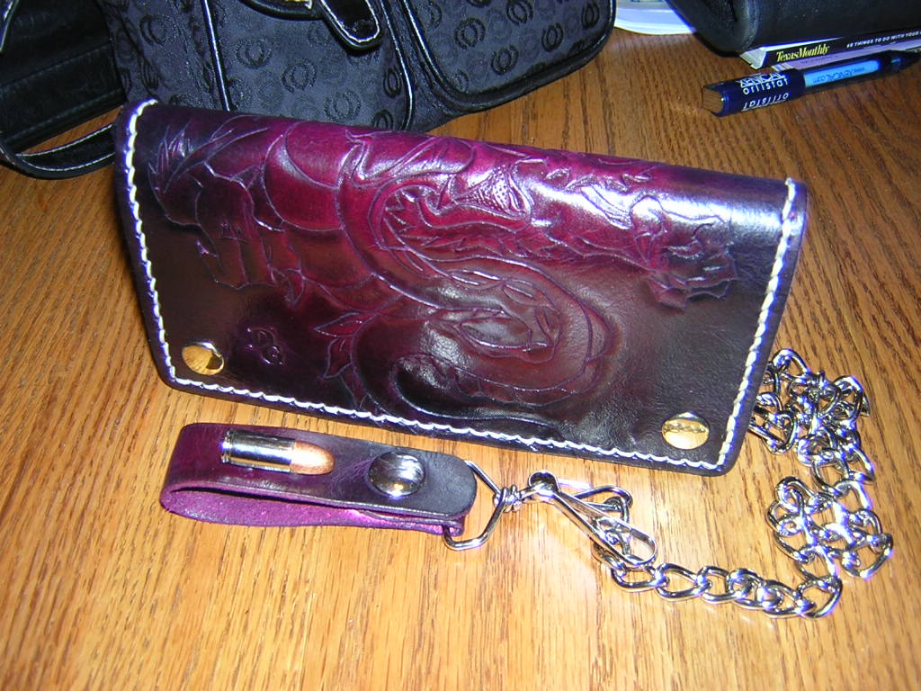

  5. SO I am still getting to know my tools and trying to understand what it takes to make something look great. Here is my latest biker wallet. I made this for friend I am proud of it. Let me know what you think! Thanks all, Dunc

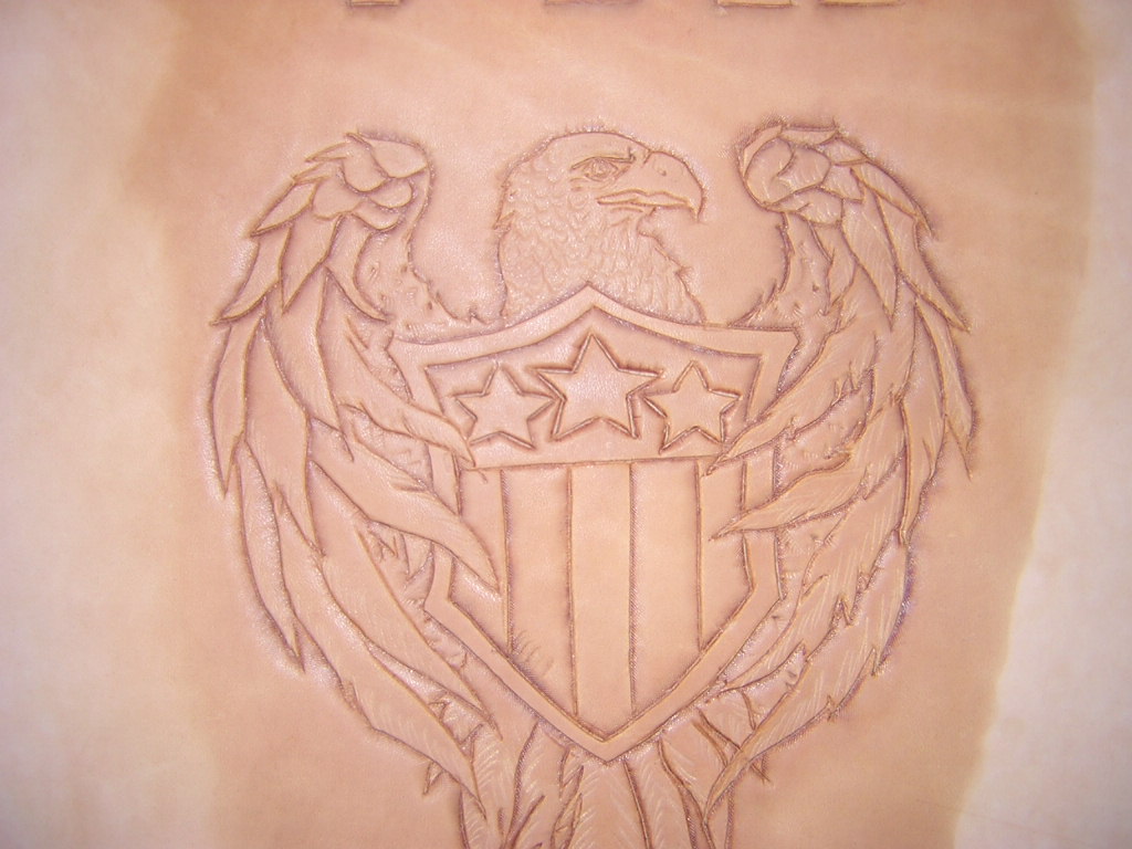

  10. Here are the pictures of my first seat. I am definitely a learn as I do type of guy and wow did I learn alot! I am working on my next seat now and will post pictures as soon as I have them. Thanks for all the help! Dunc
