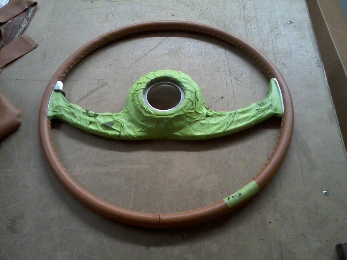

Well, the steering wheel is locked up in storage until we need it... looks like it will be a while! So I did not get the chance to take some new pictures, sorry, Fandaor! But to answer your question (and I apologize for the delay - I've been crazy busy!) about affixing to the handle, it's quite simple: I just start the Turkshead by pulling the lace UNDER one of the strands in the handle. I tie it wet (using saddle soap) and once it dries, it is a nice snug fit. I hope they have more similar projects for me in the near future! Look for "Restoration Garage" on The History Channel to see more of our projects, too! You might even see ME!! LOL KarlB

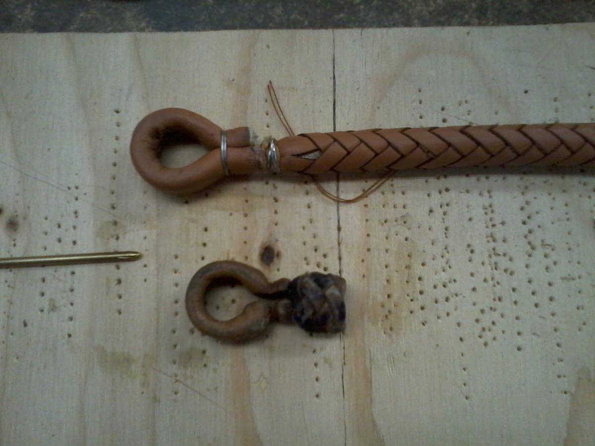

Hello, Fanador! A pleasure to make your acquaintance! I managed to figure out the Turk's Head knot that we needed on the handles, thanks to help from members on here and an excellent book by Bruce Grant, "The Encyclopedia of Rawhide and Leather Braiding." Here is a picture of one of my "practice" knots. I'm sorry, but I searched through my pictures for a better one of the steering wheel, but I can't find one! When I'm in the shop tomorrow I'll try to remember to take a close up picture of the stitching. Thanks for replying and good luck with your project! Karl
Just to let everyone know, I managed to do it! With a lot of advice and help from RCsaddles. Many thanks! I'll try to post a pic: Many thanks again! KarlB

Basically, this is what I was attempting to accomplish: They aren't perfect, and I will probably have to remake them if the Powers That Be decide so, but at least now I think I have a "handle" on how to do it! LOL Been a long hard trek, but we're getting there! KarlB
Thank you for the reply, HorsehairBraider! I really could use some one-on-one lessons at this point. The frustrating part is that what I'm trying to do is a "SIMPLE" (!!) Turk's Head, and I know I'm missing something that should be completely obvious! Also, after this automotive project is done, I may not braid again for a very long time - my preference is in making holsters. Also, none of the tack shops I've visited around here (and it is QUITE a "horsey" area!) can give any suggestions - they're only salespeople. Oh, well, I'll just keep trying, and EVENTUALLY I will "get it!" Thanks again... KarlB
That's exactly what I'm trying to accomplish on my project at work!! Specifically, I need step=by-step instruction on how to fabricate the Turksheads at either end. No matter how I try, I always end up with a tangled mess! My braiding turned out alright, though. Even Bruce Grant's Encyclopedia doesn't help me... same for YouTube... any help would be GREATLY appreciated!! (Yes, I realize this is an older post, but I'm desperate! Thanks... KarlB

Hi - it's a 1942, as I mentioned - a "concept" car, of which only one was made. Similar variants were produced after the fact, of course. Pininfarina did the coachwork. I have already successfully recreated the steering wheel covering... Lots more leather work to do! KarlB Thanks for replying! Oh - it was the first time they used the term "Golden Arrow" (or Freccia d'Oro) to label the automobile.
Hi everyone! I've been given a daunting task at my place of employment. We're restoring a one-of-a-kind automobile, and the chore has fallen upon me to do some of the leather work. Specifically, the braided "grab handles" on the rear of the front seat. I've been able to weave the basic parts and make the loop ends, but I've failed miserably at forming a decent Turk's Head knot to cover up the mating parts. Can anyone give me any hints? I have the Encyclopedia of Rawhide & Leather Braiding by Bruce Grant, and Braiding Fine Leather by David Morgan, and have watched numerous videos by Bernie 46(?) to no avail. I still end up with a tangled mess! In the photo above, my effort is above the original part I'm attempting to replicate, as close as possible. Please help!! Thanks! KarlB
