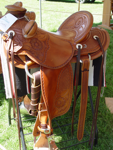

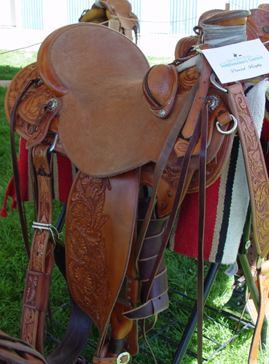

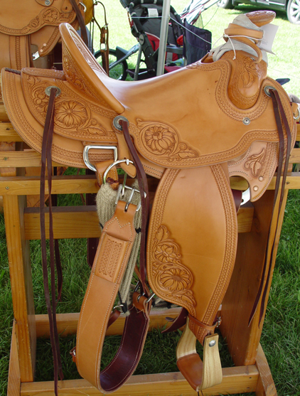

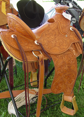

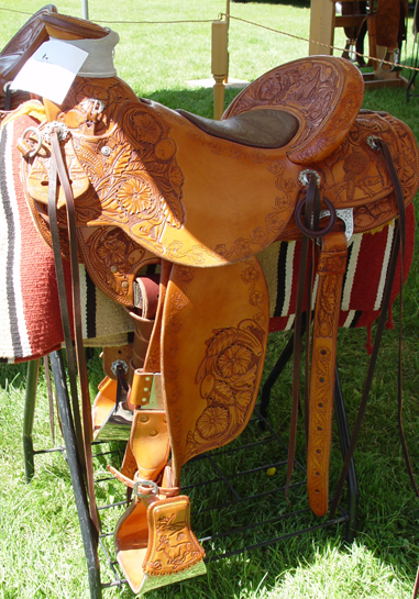

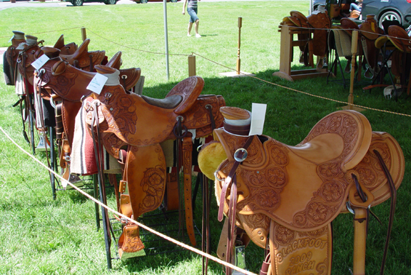

Folks, I should have brought this up sooner, We have a ranch rodeo in Blackfoot, Idaho June 26-27; and this is our fifth year we are having a saddle makers contest. Here is a pdf of the entry information, if you have any questions, ask away or give my wife a call. In the past, we have just kept it fairly local, but it sure would be good if anyone else would like to bring a saddle over. Last year we had 10 saddles entered. Let us know if you have any questions. Thanks- Chris entry.pdf entry.pdf
