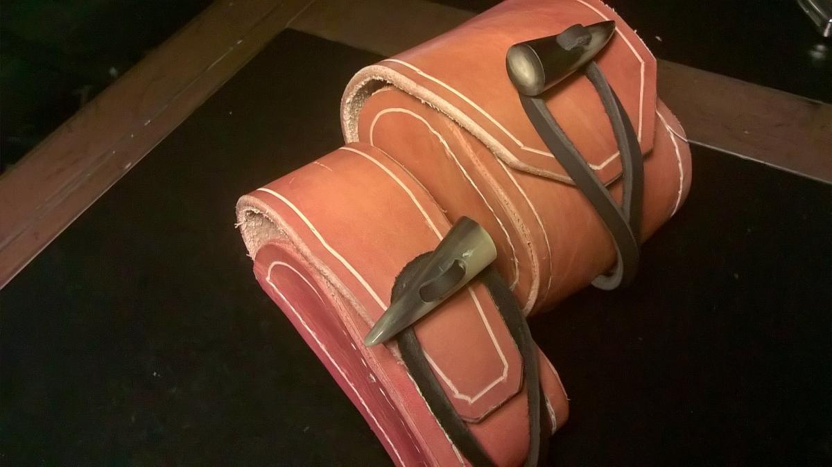

  1. I just finished this belated Father's Day present which I started making on the week of father's day. I told him it would take a few days. Lots of "firsts" in this build: First time: designing a pouch that wasn't just a folded flap using a french beveler sewing miter joints using horn toggles utilizing buttons of any kind sewing with real thread achieving a pleasing dye effect using real lace And probably a half dozen other new experiences. Lots of help and advice came from wonderful leathercrafters here! Thank you!

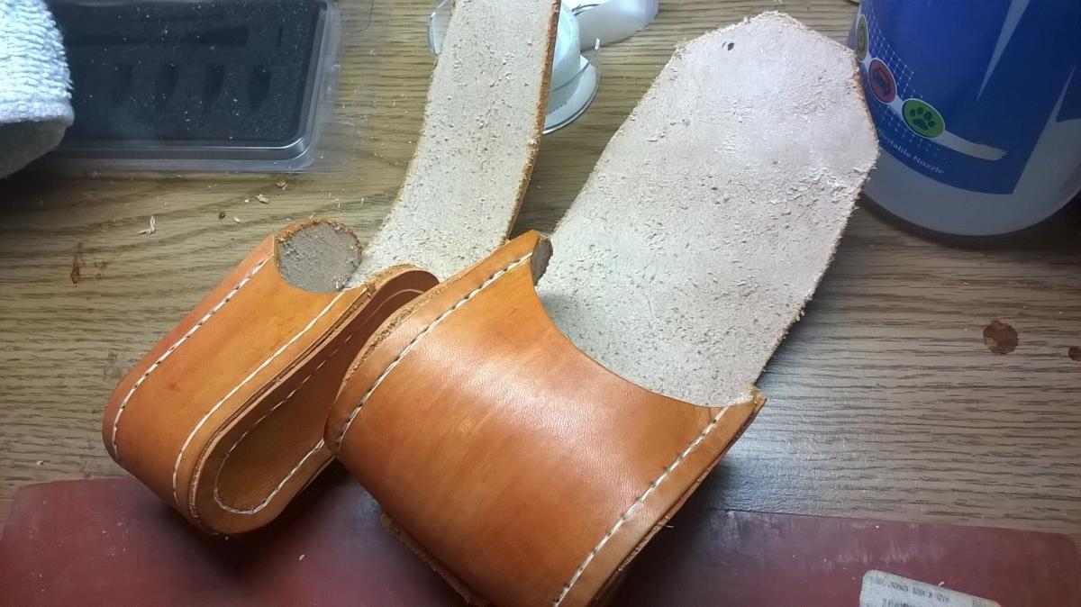

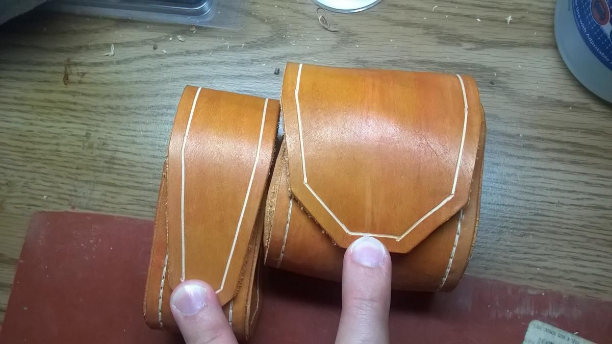

  5. Hey folks, I'm hoping someone wise can tell me what I'm doing wrong. I've yet to get my edge groover to gouge around a nice curved edge without wandering all around like it's been in a bar all night. I can carve a straight border line just fine, but the curves are a pain in the butt I can't get right. Less of an issue is straight lines that meet at an angle like in the second photo. I'm fairly certain I can lick those with just a little more patience. I've gotten plenty of practice (30 oval keychains each with a gouged border, hooey) and still can't maintain a nice smooth curved border line. Pictures here are of my latest test project. I'm about to try making it a second time and want to know if there are any ways I can improve. I'm going to try marking the line with my compass and freehanding the groove with 100X more diligence and see if that helps. Any suggestions? The tool in question: https://www.tandyleather.com/en-usd/search/searchresults/88081-00.aspx
