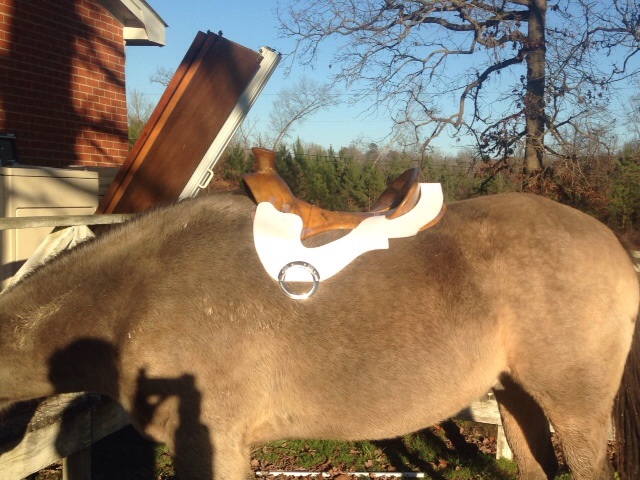

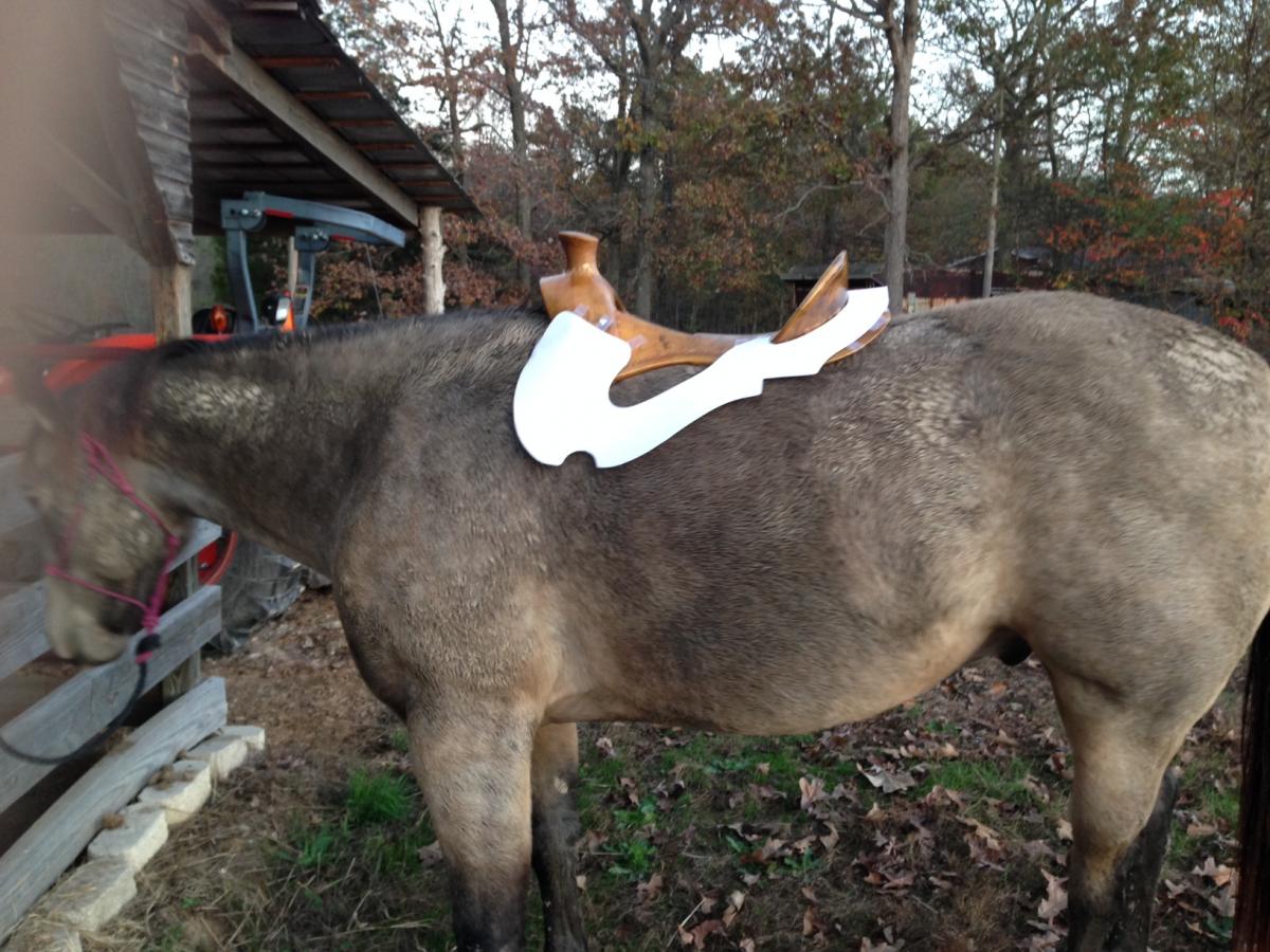

  11. So I'm working on my first saddle and I'm trying to get the rigging pattern right before I start cutting into leather. This is what I have so far. RangerRiggingPicture2 RangerRiggingPicture3 I started with the Al Stohlman style flat plate rigging in his saddle making encyclopedia books. I have modified it to the shape I like and for the back half to fit the curve of the cantle since it was way off before. I'm not sure if its full position or 7/8th or whatever it is but it seems to line up with Ranger's girth line and it seems to pull well on the saddle tree which is what I'm looking for. So the questions I have: Is the rigging too far forward? Is if too far up the swell? (I can always take leather out rather than put it back) And last but not least: If the rigging ring (I'm using Jeremiah Watt's inskirt rigging ring rather than the rigging plate) will end up too far down after it is installed in the rigging leather? Any help or comments would be very much apreciated! RangerRiggingPicture2 RangerRiggingPicture3
