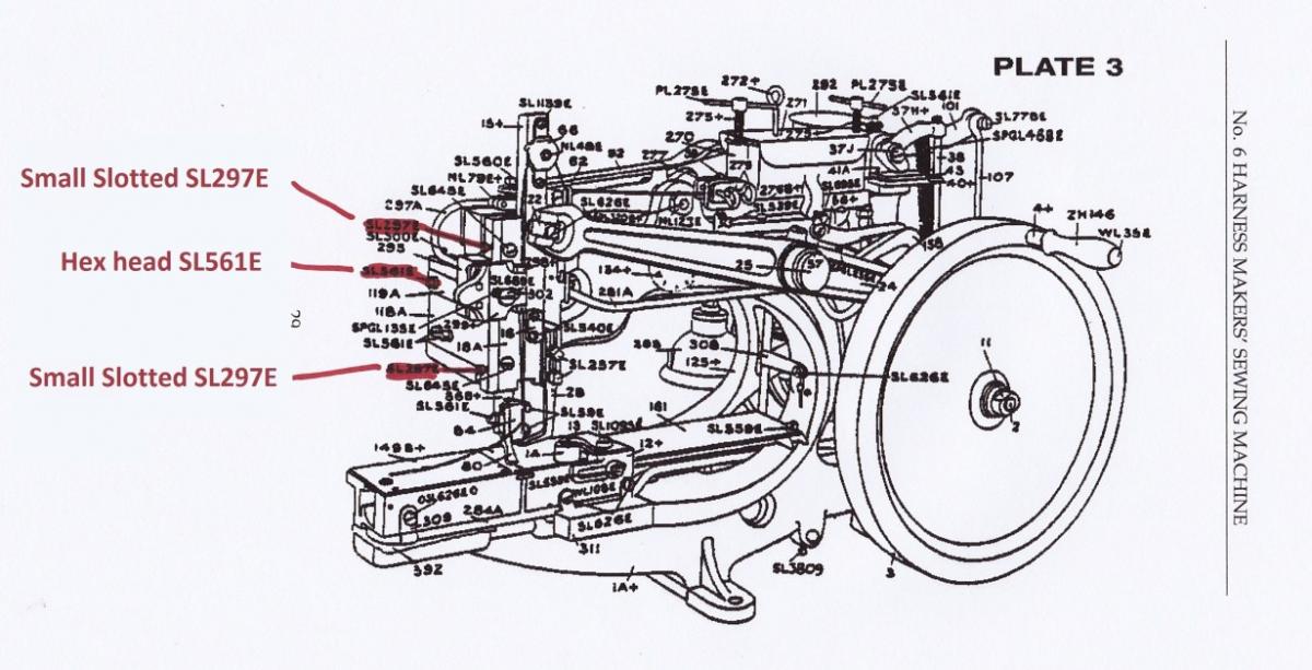

  2. Here are some photos of the new bolts in the machine and out, as well as the part number diagram (with thanks to amuckart for the original copy :-) ) As I said, they weren't cheap! So I would need to ask £20 each (ex postage). The engineer didn't differentiate between sizes, he just charged me the same per bolt. Hex head Small slotted Bolts in the machine Diagram showing part numbers
  3. Hi all, a while ago I posted on here asking if any kind people had some spare bolts/screws for the No 6 harness machine as am doing mine up and a few had sheared off. I (really my dad!) had managed to drill the old ones out without harming the thread but I couldn't find any replacements. I had some sent from Australia which gave me one that I needed, then I went to see other companies who told me I would need to order 5000 (!!!) but they could be made. Well, update is I found a very nice engineer in Cirencester who has made me some! They weren't cheap but I now have a properly working No 6 for the first time since I bought it! I didn't notice these sheared off bolts when I bought it and had I seen them I wouldn't have got it but you live and learn. Anyway, I have a couple of extras so if anyone has need of the large hex head bolts that attach one of the plates to the side of the head or the slot head small bolts that position these plates before the main bolts secure them then do get in contact. My friendly engineer told me in 30 odd years he had not seen a thread like it. He usually works on classic cars and was doing something to a Ferrari Testarossa the same week he did my bolts for me. I only needed two of the bolts copied but I am sure he would do others if people needed him to.
  4. I did read your refurb post with interest, it is what prompted me to post myself as before then I was unsure as to how complete the remaining machines are, seeing as mine seems to be missing most of it's accessories along with some important screws! The real beauty is their simplicity which means it is repairable thank goodness. I do have the bobbin winder which now has a fancy new wooden handle rescued from an old and past it domestic Singer. It is without the wax tray unfortunately and it seems to have a different number on it to the machine so they may not be originally paired up together. Right, photos of my machine before I started on it (hope they work!). It is now much cleaner and has the broken off crews removed as well as the shuttle spring replaced etc. All I need to do is replace the screws then get the alignment correct and it should be good to go. It would be nice to repaint including the gold but I need to sell it on for financial/space reasons so that will have to be down to the new owner should they wish to do it.
