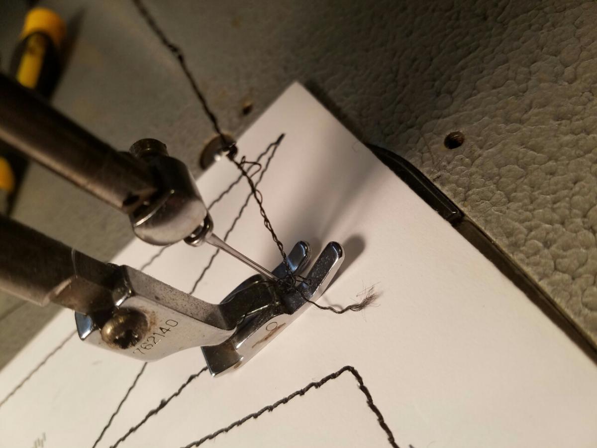

  2. Wizcraft, Thank you for the great info. I honestly don't know if it's threaded right because I can't find a manual for it. I've gotten it to sew great with lighter threads and that's one of the reasons I figured it was threaded right. However, for some reason this particular thread combo is giving me these result. Eric, I'll have to look into the check spring and how to move it as this machine doesn't have the set screw that your mentioning. I watched it last night as it was sewing and it is definitely going through the thread and then starts doing what you see in the picture. I was able to get it to run about 24" without any problems but the tension on the top was set to the max and it kept clicking due to the tension being so high. As I backed it off to where the clicking noise went away the shredding cam back. Which makes me believe that the check spring is what I need to make sure is adjusted right when I get home tonight. I must say this is probably the best form I have been on in years. There's a lot of knowledge for machines I couldn't find anywhere else. I even was able to order a personal leather stamp from one of the sponsors. Respectfully, Ed
  3. Ok, have another sewing machine question on this industrial New Home Machine. I have attached a picture of the machine and the model number. I can't seem to find any information. My google fu is weak for some reason. Any help is greatly appreciated. Next question is the shredding of the thread. Keeps happening no matter what I have been doing with thread and needle combo. What you see in the picture is size 18 needle and #69 bonded nylon.
