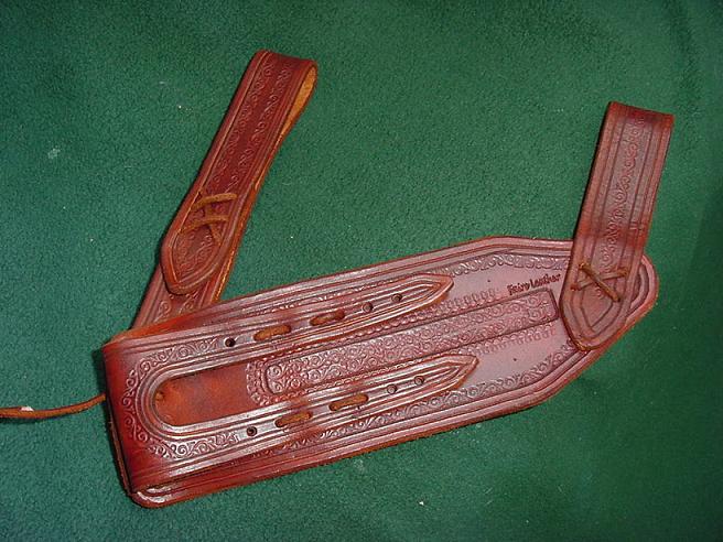

  3. I don't craft items for stock, but TRF is my home Faire. Here is a hanger/frog I made several years ago based on a piece I saw in a museum in Portugal. Exact time period unknown, but I suspect it was pretty early considering the scabbard was tied into the rig.
