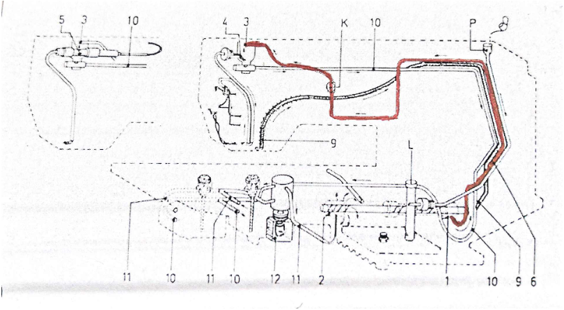

  1. Adding to above, I am a bit lost where this line/pipe is attached to the hook shaft i.e. the source where the oil comes from
  2. Acquired a second hand Adler 467 some time ago. I am in the process of getting the machine running and discovered that the supply line (pipe) is missing altogether. What I gather from the manuals I downloaded, thanks to this forum, this line gets its supply from the the hook shaft. It then goes through a non-return valve and routes via the sight glass to a brass pipe whereafter it feeds a small sump in the head. I am sure that one can make up this line adding the non-return valve. I am a bit lost when it comes to the I shall appreciate it if someone can direct me and even better send a photo or two on this. A further help would be the exact routing inside the machine via the sight glass.
