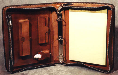

Members equiss Posted January 15, 2009 Members Report Posted January 15, 2009 Hello everyone, I am hoping that someone out there can help me, I would like to make some portfolio, paper carriers, zippered binders like the picture shown that is off of a website under the directors chair post, but I haven't the slightest idea where to start. I have all the Stohlman construction secrets books, but still - I don't have a clue on how a person would go put on together and make a pattern for the folio, card case slots, and pen slot. Anyone have a pattern that they would be willing to share with me? OR, instructions on how to get startd with just a basic zippered portfolio? Quote

Moderator bruce johnson Posted January 15, 2009 Moderator Report Posted January 15, 2009 For a lot of stuff there aren't going to be any published patterns. The principles are in the Stohlman case book series. For the rest of it, you just have to fit, fudge, and swear sometimes unfortunately. Most of the time you have to make up your own zipper. For the pockets and loops it depends on what size pen, how many business cards, and stuff like that. Quote
Members GregGaub Posted January 16, 2009 Members Report Posted January 16, 2009 I made this "Writer's Briefcase" based purely on the Stohlman books. The customer had some very specific requirements for the inside, which I did my best to meet. Although there are a lot of things I'd do differently, the customer loved it, and I think it turned out pretty good. No pattern used, and I'd never done anything like it before. Quote
King's X Posted January 16, 2009 Report Posted January 16, 2009 GregGaub said: I made this "Writer's Briefcase" based purely on the Stohlman books. The customer had some very specific requirements for the inside, which I did my best to meet. Although there are a lot of things I'd do differently, the customer loved it, and I think it turned out pretty good. No pattern used, and I'd never done anything like it before. I don't mean to trump this topic, but I have to say this is beautiful! Greetings from Round Rock, Texas Quote
Members equiss Posted January 16, 2009 Author Members Report Posted January 16, 2009 ATX said: I don't mean to trump this topic, but I have to say this is beautiful!Greetings from Round Rock, Texas WOW - that is really pretty! thanks for all of the comments, I guess part of my problem is that I am afraid to make mistakes, but that is how people have to learn. It is expensive to make mistakes....but I know it is what i have to do. I have questions though like what oz. of leather do you use for the outside, inside, etc. Good job, it is a beautiful case! Quote
Members GregGaub Posted January 16, 2009 Members Report Posted January 16, 2009 Thanks, ATX, I appreciate that. I hope it makes my point, though. I had never made anything like it. In fact, I've not made anything like it since then. I used the 3 Stohlman case making books as my guide, and managed to get through just fine. I turn to those three books more than any other book in my library. You can follow the patterns in there, but it's primarily a guide for showing you how to do lots of things that you might need for your own, custom projects. Just make your needed adjustments to the patterns, and go for it! Quote
Members GregGaub Posted January 16, 2009 Members Report Posted January 16, 2009 equiss said: WOW - that is really pretty! thanks for all of the comments, I guess part of my problem is that I am afraid to make mistakes, but that is how people have to learn. It is expensive to make mistakes....but I know it is what i have to do. If you follow Al's guides, and carefully plan things out based on his incredible resource in those three books, you won't make any mistakes that you'll really regret, or cause you to start over. Sure, you might do some things better the next time. Your cases will surely get better and better with each one you make, but definitely don't sweat it. With those books, it's almost like having him right there in your shop with you. equiss said: I have questions though like what oz. of leather do you use for the outside, inside, etc. I usually work with relatively thin hides, between 5 and 8 ounces. I rarely get anything really heavy, and I'll only sometimes get something thinner if I know I'll need/use it for something. To add stiffness, I'll glue a piece of paperboard (like from the back of a notepad) between the layers of leather for the front, back, and spine. equiss said: Good job, it is a beautiful case! Thanks! I was as apprehensive as you are when I made it, but I bit my lip, told myself "just DO it" and gave it the ol' college try. I'm still proud of it, even if I would do some things differently. -Greg Quote
