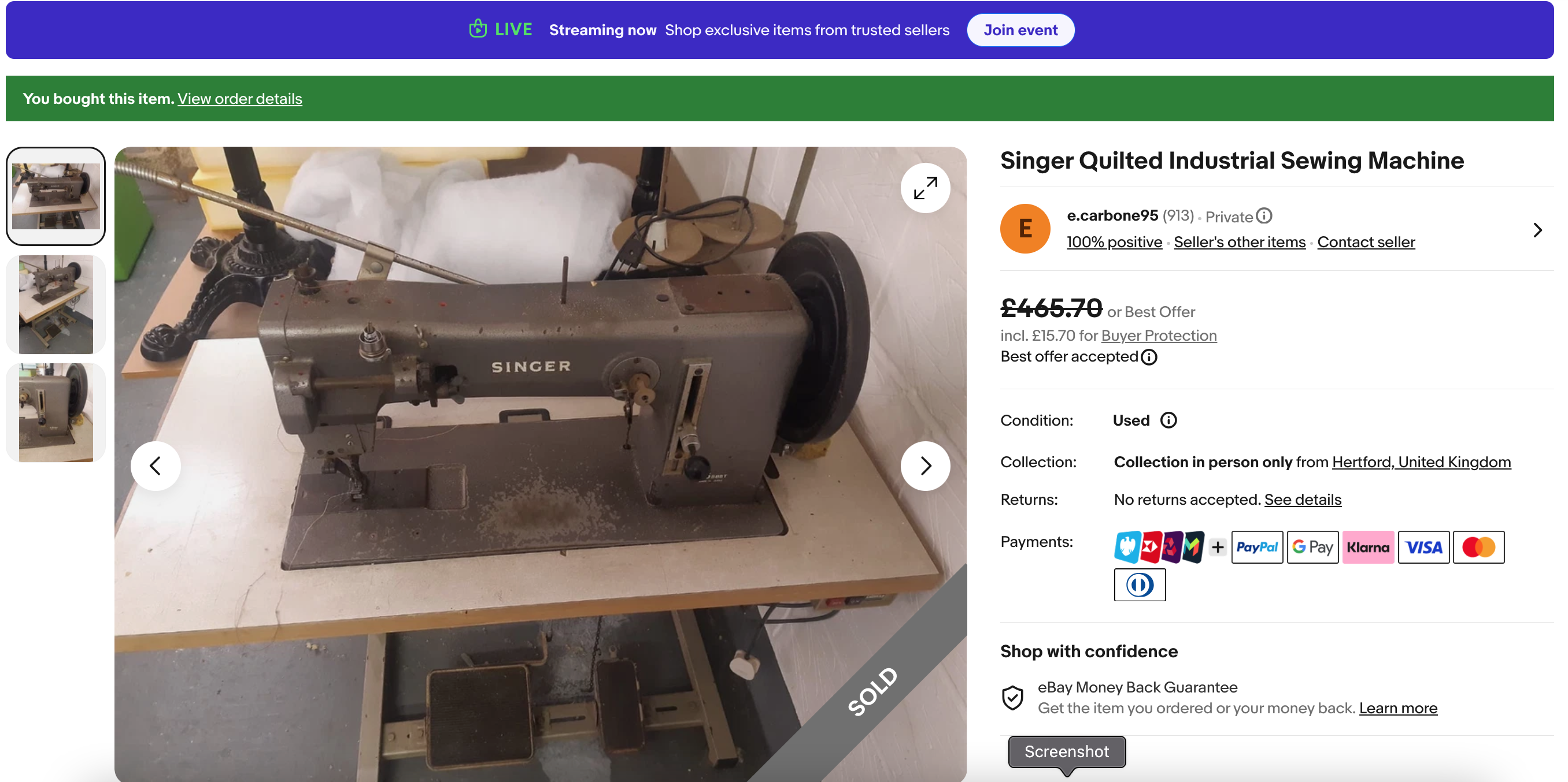

Hi, first time to post on here. I read this post and wondered if you were successful to use CH-8B presser feet on the TH-8B machine? I recently acquired this Singer 45B8Bt off ebay with a low ball offer of £260. The machine was made by Seiko (basically same machine as TH-8B). After tidying up and replacing the clutch motor with servo & speed reducer, I'm really pleased with the machine sewing leather. The presser foot is huge though so it's difficult to be precise close to edges, I want a second foot to grind away the right hand side. But the price of a new TH-8B foot set is more than I paid for the machine! Generic CH-8b feet are available at a much more reasonable price, but I guess there are some differences because they are different part numbers to the TH-8B feet. Are they the same height?
