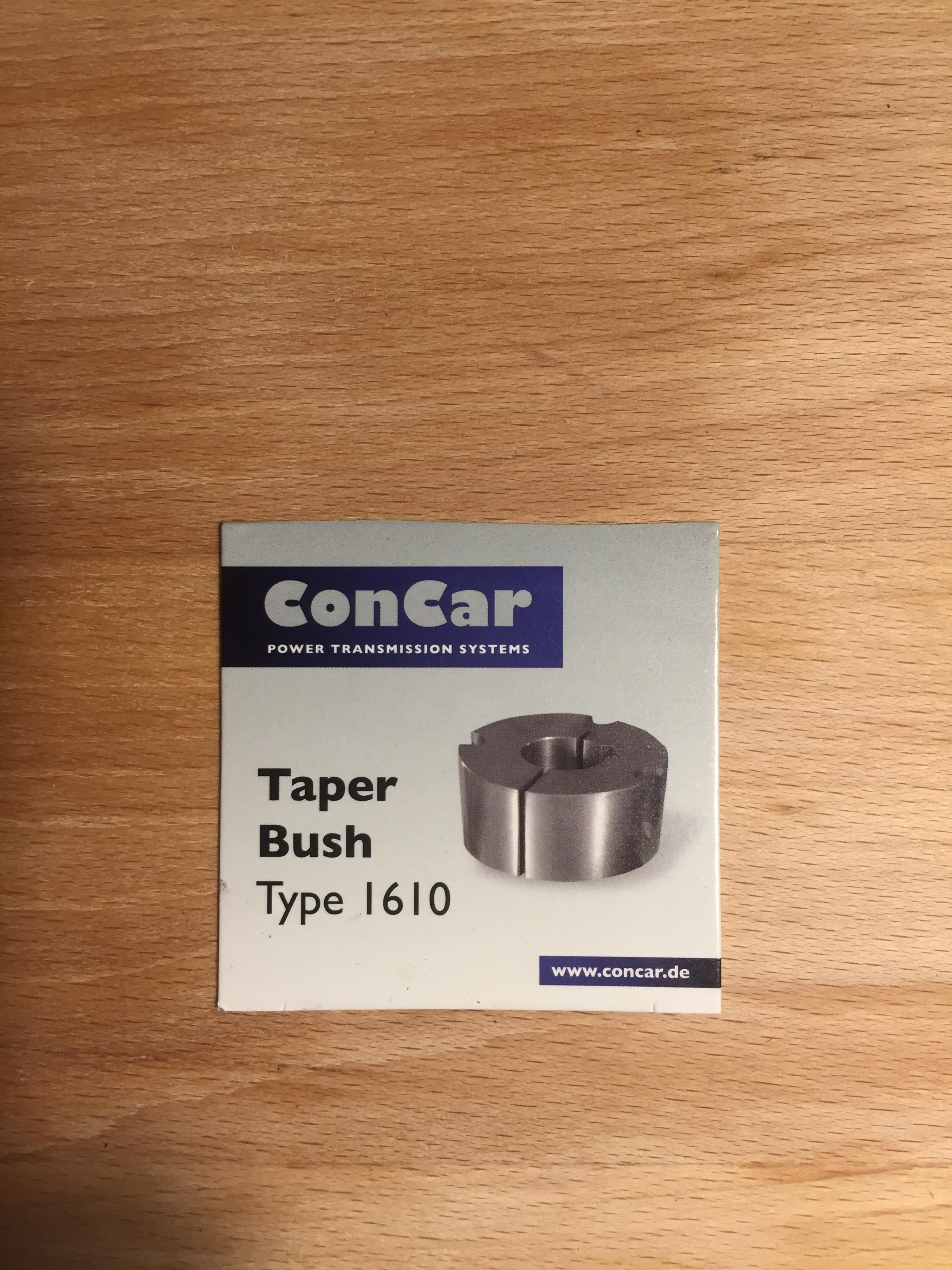

Members Tigweldor Posted April 24, 2025 Members Report Posted April 24, 2025 Just came in by courier : 190mm pulley and taperlock bushing with 14mm (= 9/16") bore diameter. Will be installed on my 29K33 - which I lent to my next door neighbor to sew about 100 patches onto 3 denim vests - he is still not home from work. That should slow it down quite a bit - still waiting for the SPZ belt though. I can thoroughly recommend these taperlock bushings for sewing machine drive shafts - the little torque exerted by sewing machine motors or treadles is way less than the cinched up bushing can handle - no key needed with this unit - though it has a key slot in the bushing. The nice thing is that you can play around with different size pulleys, ranging from 50mm to 190mm for the 1610 bushing - which comes for all size shaft diameters. Total cost incl. shipping was 38€ - an investment that will not break the bank. Greetings Hans Quote
