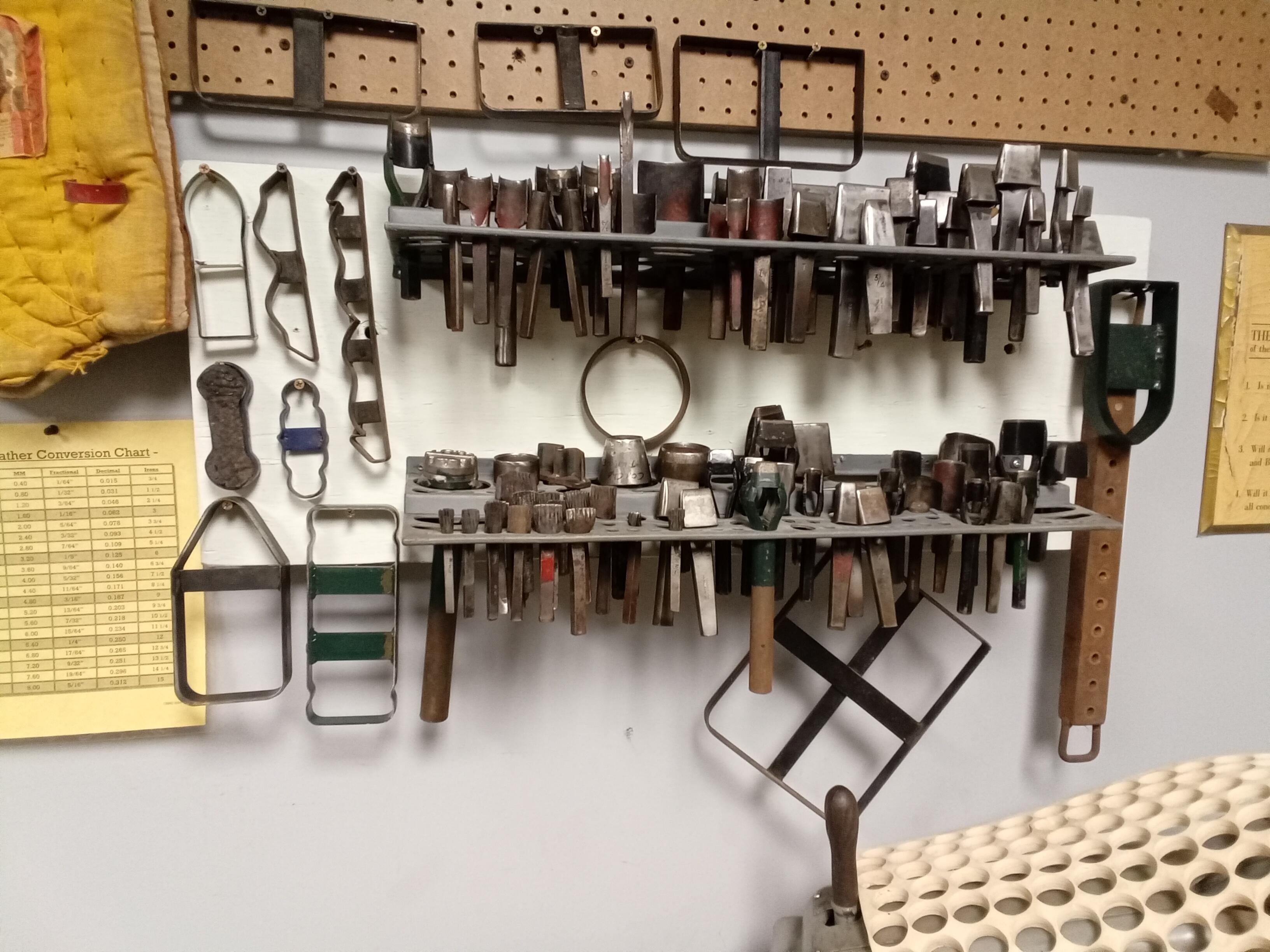

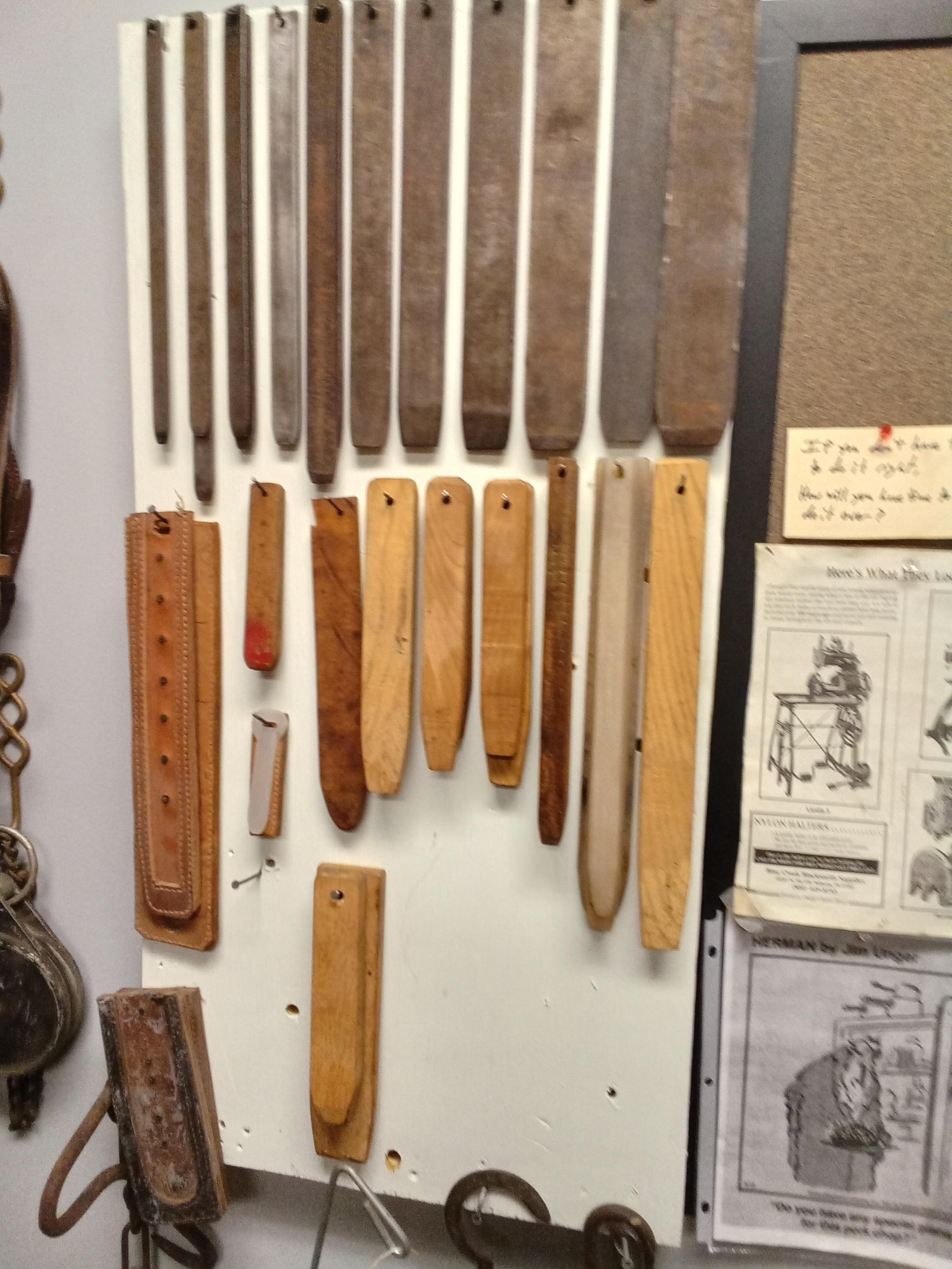

Members mbnaegle Posted May 7 Author Members Report Posted May 7 Here's the back of the bench currently. The draw knives I have on their sides in leather loops, but don't like this. A lot of knives have makeshift wood and leather slots presently that I'm going to replace with sewn leather sheaths that I'll screw or tack to the sides of the cubbies. The round knife sheaths work well, as do the racks for the edgers, but they're crowded and need more sorting (theres even more in the drawers!). The pin cushions work well for loose needle and awl and drapery pin storage. The Landis 16 plate is there as my Dad had one when he was doing full time saddle and harness work and loved it, but sold it at some point (kept his two Landis 3's thankfully). We a different one come through our shop a few years ago that was worn out and half gutted of parts, so I saved the plate for him before it went to the scrap pile. Here's the wall organizers. Mainly long and cumbersome stuff, and the punches and clicker dies are beside his old clicker (its pad gets used for hand punching stuff too). Quote

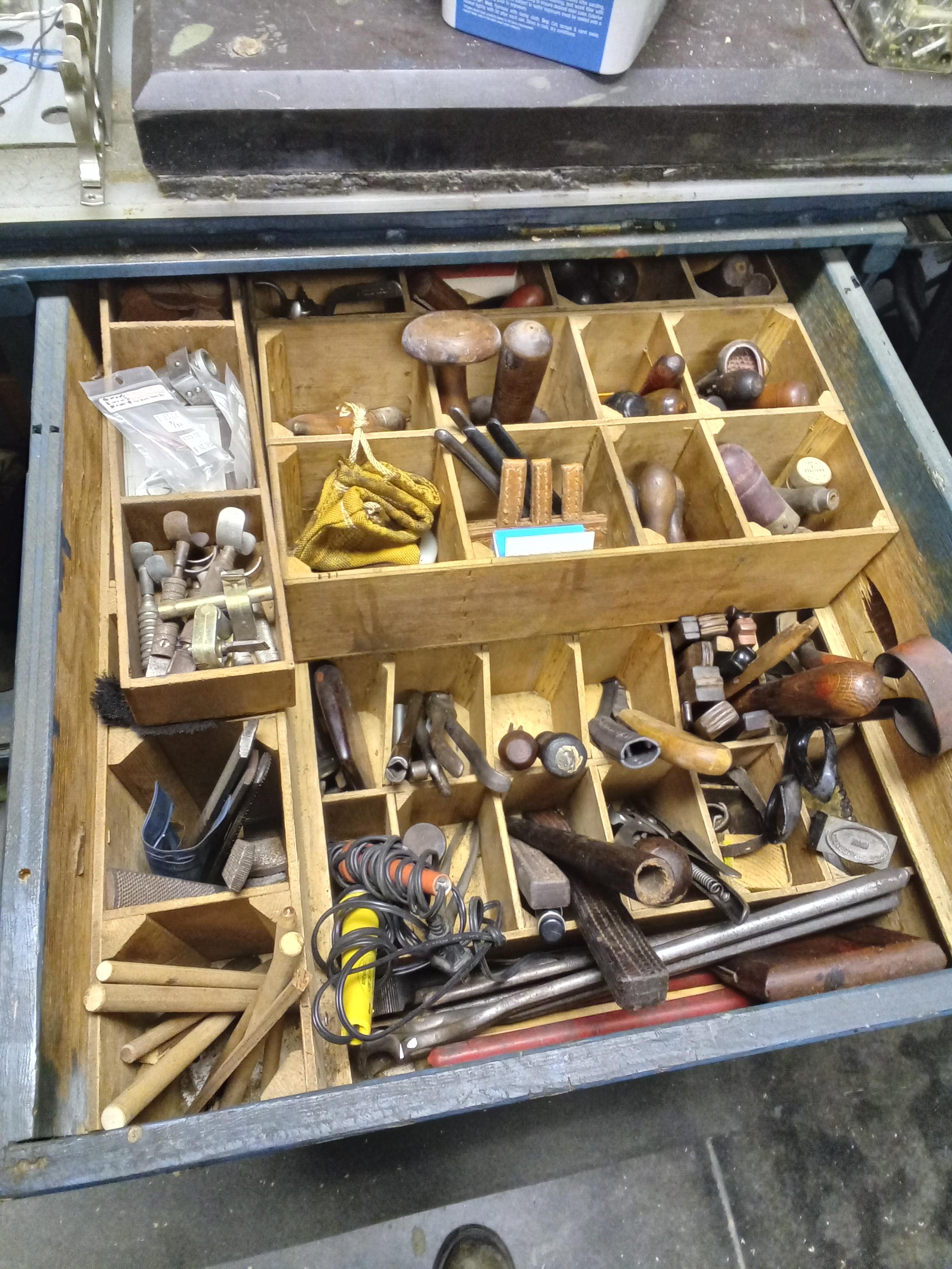

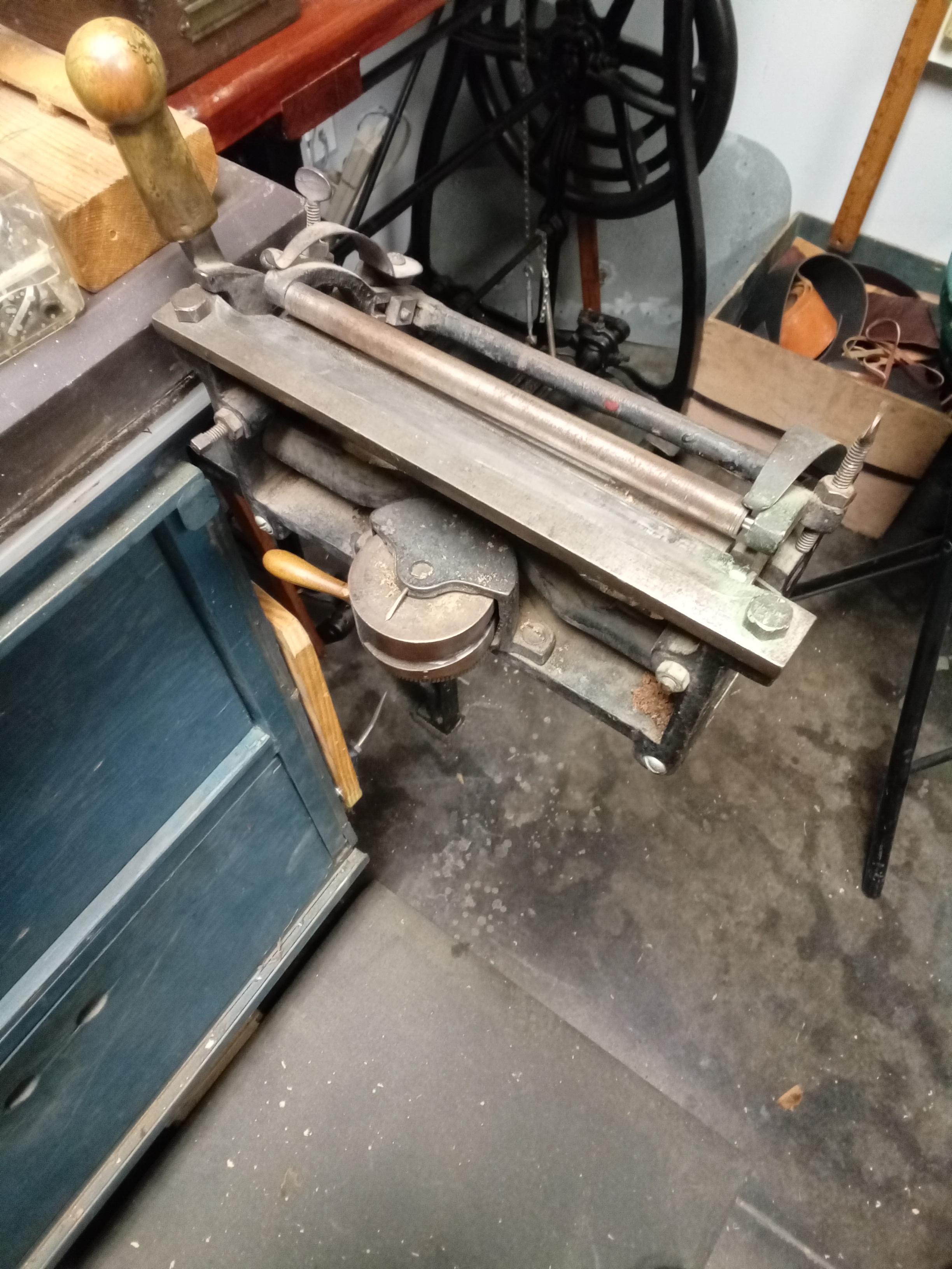

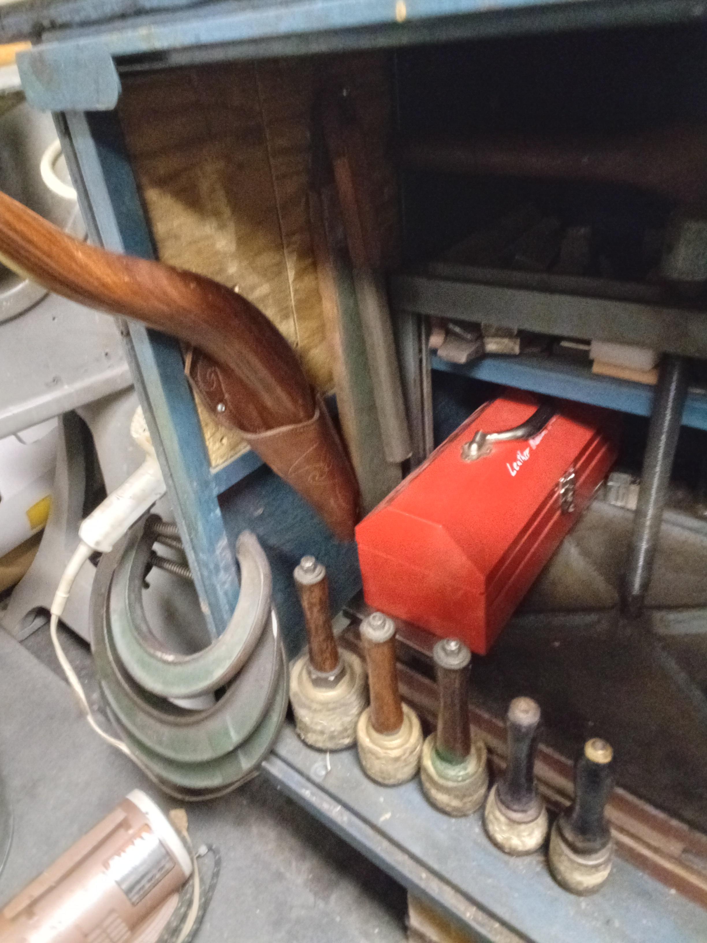

Members mbnaegle Posted May 7 Author Members Report Posted May 7 This is the drawers in the bench. Wide deep drawers with lots of cubbies and removable trays. Lots of space, but not quick to access. There's some big open shelves under the bench too. Mainly used for heavy stuff. Dad sewed up a lot of sheathes for some tools, like the one for his big slicker. He also kept a few Deep frame C-clamps at the bench as they could reach into a saddle seat to hold or set something in place. The bench is steel framed sheathed in plywood, and when he welded it up he made a long steel slot in the end and his bench splitter (an old "Krebs type" Randall) is mounted to a steel plank that fits into the slot. It's a fantastic configuration in use with all your scrap falling to the ground and ample room around the tool to work with it, and when you are done it slides out and hangs on the side of the bench. I've started mounting other small hand pull bench tools to planks to use the same routine, so they're all easy to use but don't take up any bench space. Quote
