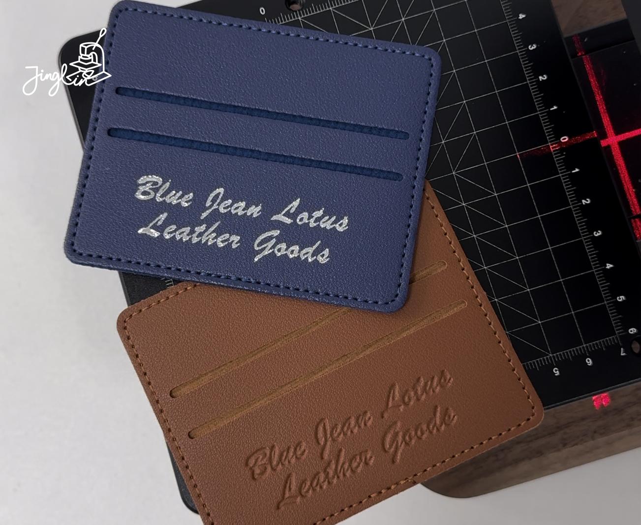

Personalized leather goods have become increasingly popular as thoughtful gifts and stylish accessories. One of the most elegant and eye-catching ways to customize leather is with foil monograms. Whether you're crafting handmade leather wallets or offering a luxury branding service, this guide will show you how to personalize leather goods using foil stamping to create professional and lasting impressions.JinglinStampingMachine_11.jpg.cf2ed37725836d5ae494ef472d458af8.jpg

Step-by-Step Guide to Foil Monogramming Leather
1. Prepare the Leather Surface
Ensure the leather is clean, dry, and flat. If needed, lightly dampen the area to be stamped to help the foil adhere better.
2. Set Up the Hot Foil Machine
Adjust the machine’s temperature and pressure according to the foil and leather type. Most leather foil stamping is done at 100–130°C (212–266°F).
3. Align the Monogram
Place the metal dies or logo plate into the press and carefully position the leather item underneath. Use alignment tools to ensure perfect placement.
4. Apply Heat and Pressure
Lower the press onto the leather with even pressure. Hold for 1–2 seconds, then lift. The foil should transfer cleanly to the leather.
5. Inspect and Touch Up
Let the leather cool, then check the imprint. If needed, re-stamp any missed areas or carefully remove excess foil.
