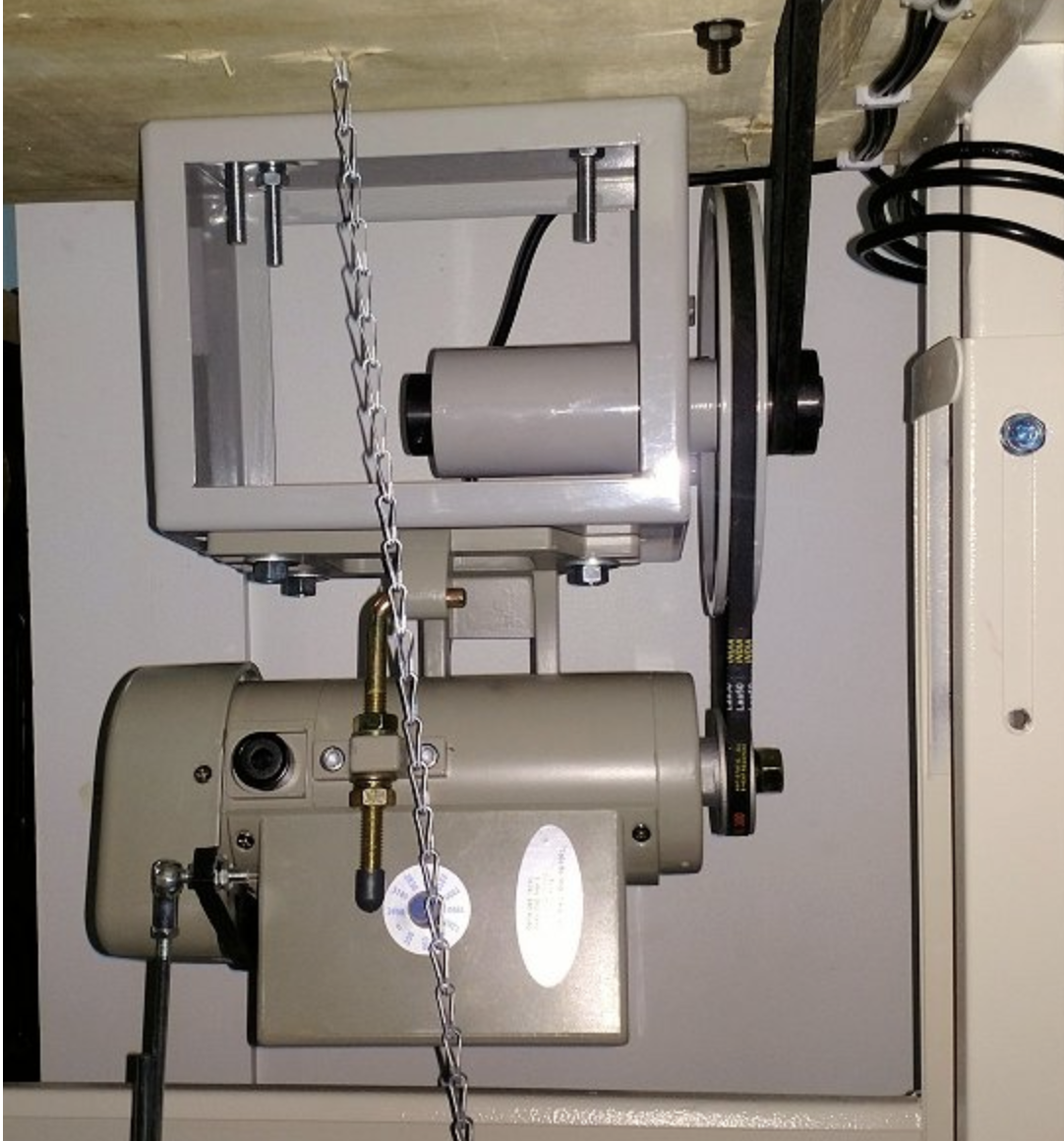

Members ozleather Posted June 25, 2025 Author Members Report Posted June 25, 2025 My main focus is automotive upholstery but I would like to learn how to do things from leather. I am thinking of belts, bags, probably made from not the thickest materials. You suggested a speed reducer pulley and replace the servo motor pulley. Are you referring to a speed reducer showing on the picture below? Quote
kgg Posted June 25, 2025 Report Posted June 25, 2025 2 hours ago, ozleather said: I am thinking of belts, bags, probably made from not the thickest materials. Keep in mind: i) Items like belts / wallets are best done on flatbed like a Juki DNU-1541S or clone. ii) Items like bags are best done on a cylinder arm machine like the a Juki LS-1341 or clone. iii) You can turn a cylinder arm machine into a flatbed machine by installing a flatbed attachment. If this is going to be your only machine I would suggest seriously looking at this option. 2 hours ago, ozleather said: Are you referring to a speed reducer showing on the picture below? That is one style of speed reducer typically referred to as a box style. You can also get the more common pedestal style. Both have their pro's and cons but do the job, speed reduction. Here is a photo I copied from Toledo Industrial Sewing Machines ( https://www.tolindsewmach.com/motors.html ) The motor shown in your photo is a brushed servo motor, good uncomplicated work horses. kgg Quote Juki DNU - 1541S, Juki DU - 1181N, Singer 29K - 71(1949), Chinese Patcher (Tinkers Delight), Warlock TSC-441, Techsew 2750 Pro, Consew DCS-S4 Skiver
