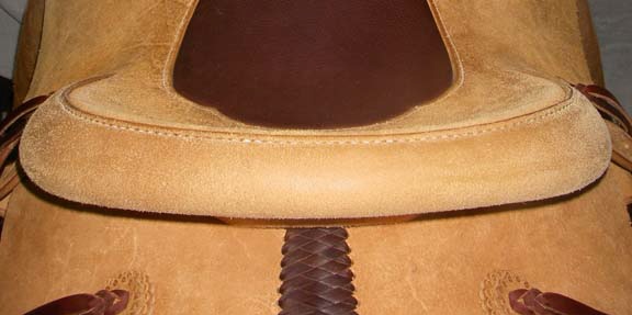

I think the thing that will help you the most is how you construct the whole bind in the first place. If all the layers of leather that make up the bind are of good quality and installed properly, the bind will be very firm and tight. I use a front and back cantle filler to help firm the bind up, there will 4 layers of leather before I put the final bind on. Then when installing the final bind keep the top leading edge as close as possible to the front of the cantle, then make your mark out to make your final cut depending on what width of a bind you would like. I see to many saddles where the leading edge of the bind is a 1/2" or more away from the front cantle edge, instead of 1/8" away. All this does is make a wider and weaker bind. I think in a perfect world the cantle bind will have no movement or wiggle when new, that way 10 years down the road it will still be a nice tight bind.
I have added a photo, notice how close the bind is to the front of the cantle. I believe that this makes a much stronger bind than having the leading edge back another 1/2" or more.
