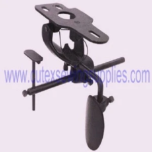

Hello,  I'm looking for help with the knee lifter placement for my recently purchased Singer 112W115 double needle machine.  I purchased a table top and had some difficulty finding mounts for the machine head, but finally got that resolved (I think).  I installed the oil drip pan, motor and belt.  I purchased a knee lift (photo attached) and lined it up with the space in the oil drip pan, but when I try to engage the knee lifter it does nothing.  What am I missing or doing wrong? Where should the knee lifter make contact with the machine?
SINGER KNEE LIFTER COMPLETE ASSEMBLY #228368 FOR 111W 112W 107W SEWING MACHINES - Picture 1 of 1
please post pictures of your machine from the rear and when tilt back from the underside and how you have installed the foot lifter.

I cannot see how you mounted the lifter but what I can see is that the roller (224413) on the lifting rod (240550) is missing (isn´t it?) and the orientation of the "tab" is wrong. It has to be like the red frame IMO the longer end has to face right. Thats what I can tell the rest is trial and error where you put the foot lifter assy.

Thanks for the information.  I will make the adjustment and see how it goes.  I really appreciate your assistance.
This is the knee lifter I purchased for this machine.  It doesn't include the roller you mentioned in the other example.

no, it belongs to the machine. See parts diagram I pointed where it does on. The lifting rod I mentioned is not part of the knee lifter.

Did you get your knee lifter working?
Yes I did for the most part.  I realized the knee lifter I bought wasn't made correctly.  The 228365 wasn't moving up and down through the 228362 like in the diagram above.  I got another one and immediately saw the difference.  I'm still working on some fine tuning to get it to catch the knee lifter properly.   The table top I bought has been giving me machine fitment issues from the start (don't ever buy a table top from Goldstar, tons of issues with it and shipping was horrible, I'm sticking with Prizzi going forward).  I'm dealing with a timing issue now as I went to a bigger needle size and not finding much info on how to set timing on these machines.  I'm about to post a thread for help on that now.

I was able to get the knee lifter replaced and I installed it to now engage the lifting rod.  But as you can see in the video, it lifts the rod but still doesn't lift the presser bar.  @Constabulary mentioned that I may be missing a part (#224413) that connects to the rod.  I tried locating a visual or video that shows the connection, but was unsuccessful.  If you can offer any advice on installing that part or a way I can get this to work, I would greatly appreciate it.
