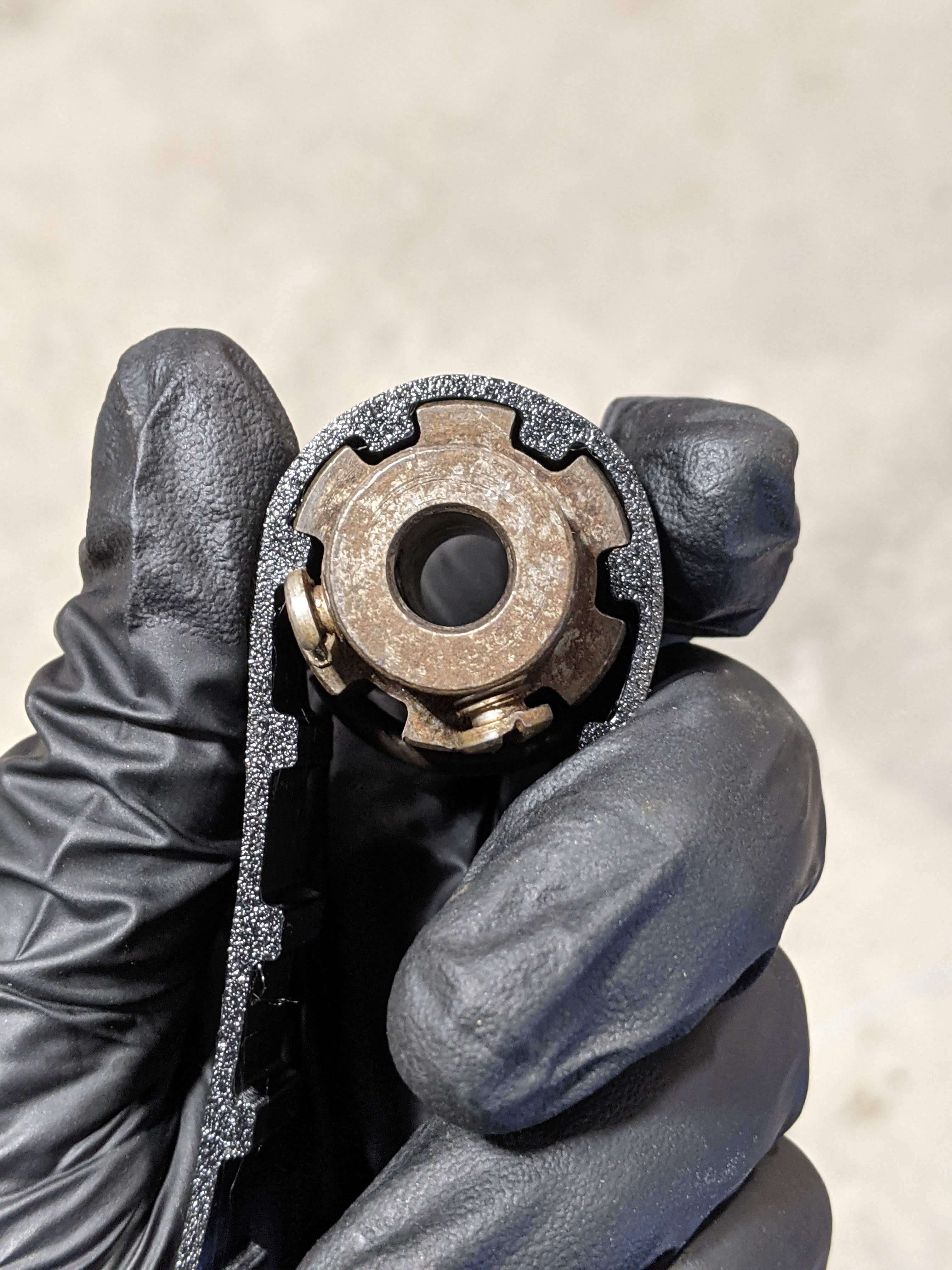

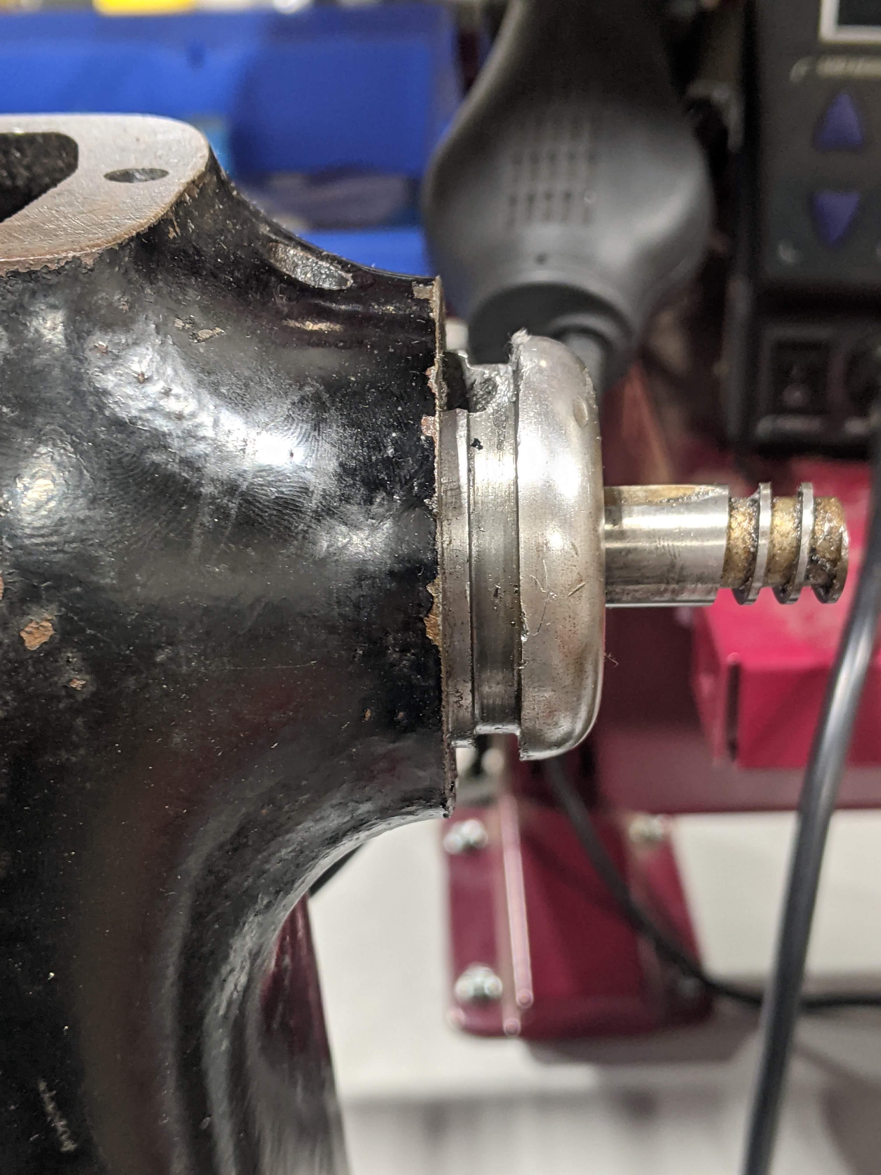

Members Constabulary Posted Monday at 06:12 AM Members Report Posted Monday at 06:12 AM 6 hours ago, brongle said: so it should able to drive a swinging attachment plate. yes, there is a short pin on the underside of the swing plate that goes into the slot in the feed dog and the moving feed dog governs the swing plated. 7 hours ago, brongle said: Any idea what the slot engages with, if anything? I couldn't feel much in there with the screwdriver, and the below is definitely a bit simplified. One thought that comes to mind is that it might act as a sort of flexure brake, expanding slightly against the inside of the driveshaft when you tighten it to keep it from shaking loose and reducing the stitch length as you sew. It engages with nothing. You can put a screw driver in the slot and with a little twist you can widen the slot a little bit so you have more friction between the spindle and the inside of the drive shaft and that IMO is for holding the spindle in place otherwise it could probably move and alter the stitch length. That what I think. 😉 Quote ~ Keep "OLD CAST IRON" alive - it´s worth it ~ Machines in use: - Singer 111G156 - Singer 307G2 - Singer 29K71 - Singer 212G141 - Singer 45D91 - Singer 132K6 - Singer 108W20 - Singer 51WSV2 - Singer 143W2
Members brongle Posted Monday at 08:05 PM Author Members Report Posted Monday at 08:05 PM 13 hours ago, Constabulary said: It engages with nothing. You can put a screw driver in the slot and with a little twist you can widen the slot a little bit so you have more friction between the spindle and the inside of the drive shaft and that IMO is for holding the spindle in place otherwise it could probably move and alter the stitch length. That what I think. 😉 Gotcha! That makes a lot of sense. Quote Current machine lineup: Durkopp-Adler Class 272, Chandsew 100rb, Singer 108WSV36
